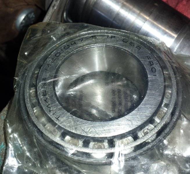

I have ZERO interest in using them on my car. Taper roller bearings flat out work and are dead nuts reliable. The adjustment process is minimal for the durability you receive in return. And it is easy. As far as end play, I set them by feel and have never had one fail.
From my cold, dead hands...View attachment 1547789View attachment 1547790
I've always done it by feel too.....and if you know what the thread pitch of the adjuster is, you can get pretty dang close without a dial indicator. And I have dial indicators lol.
