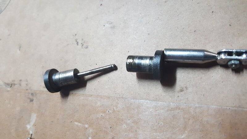

I had this situation in a SG unit recently. I took the whole pumpkin to the drive train shop to get checked out, the guy there showed me how to get it out. Looking down where the axle would enter, there's a small triangle in the button. He said take a small drift, tap it into the center of the triangle, and the other side of the button would fall out. Then reverse the procedure to get the first side out. I will be trying this next week as I assemble the 8-3/4.
And yes, you would have to pull the pumpkin. I can't see how you could do this all the way down the axle tube. The triangle is real tiny.
Here's a picture of the buttons disassembled. (Pay no attention to the magnet)

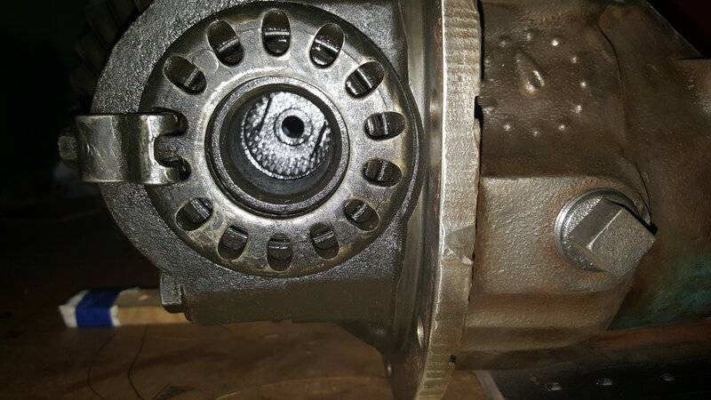

This is a picture looking inside the differential. (Button is removed)

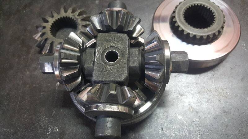

This is what you are looking at, the spider gear bar.

And with the button style in post #6, you can weld a punch to a steel rod and knock them out with the pumpkin in place if you have to. Especially the night before you are going racing and you just found out why your axles wont go in. :)
