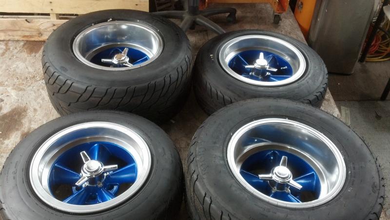

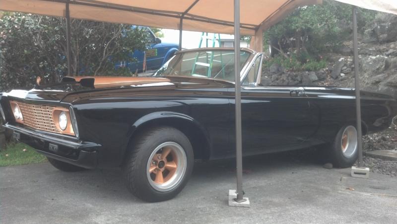

28.jpg54.jpg I changed the rim color but this is as wide as I could put on my 63 without touching. rim size 15 x 10 & 15 x 8
for having a little autocross fun. So I guess 7 is it? 4 inch back spacing or 0 offset
View attachment 236917View attachment 236918 I changed the rim color but this is as wide as I could put on my 63 without touching. rim size 15 x 10 & 15 x 8
Whats the offset/backspacing on the front? It doesn't hit on the inside or outside? How tall is the tire?
