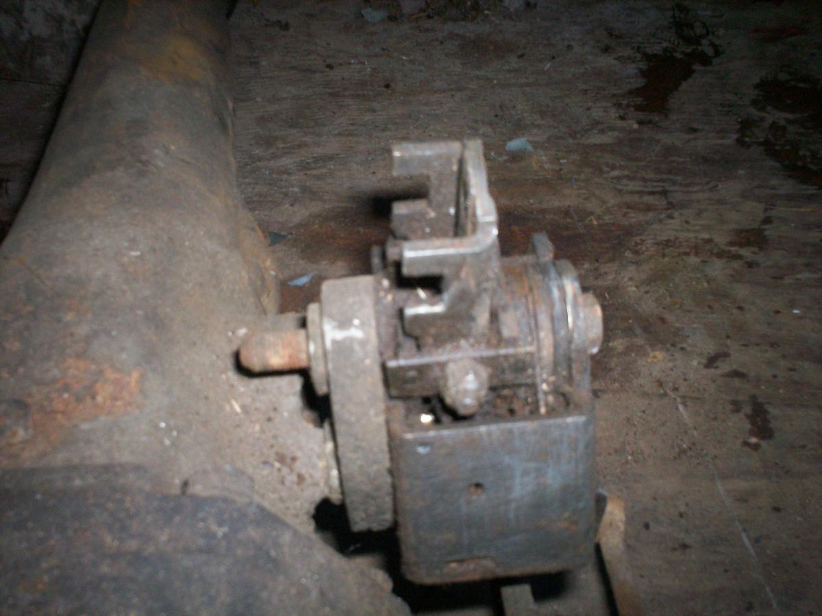

I recently came across a 833 4 spd and I am trying to identify what and where it might have come from...
I also am not sure of what type of shifter this is. If you have any input it is appreciated..There is just a patten # (3216274 3306126) on the face plate no name....There is also the # 8327 stamped on the plate...
#'s are
2 C99621
0A106274
PP8332897-0183
Thanks,
Lou
The shifter looks to be a Hurst, and the shift rods look to be from a B-Body. Maybe someone more knowledgeable will chime in on the tranny.
The pics don't show everything, but from what I can see it looks to be an early B-Body (64-67).
833's with only the shifter mounting point in your pic are for the early cars. If it's got a shifter mount back by the tailshaft it's for a later 68+ B Body. I've seen them with both and I don't know the exact details on those.
If you can see the casting number that's the best thing to do. Check it here: http://www.mymopar.com/bellhousingcastnumb.htm
70 -up A833 trans have the 2 shifter mounts on the tailshaft. So that they can be used in the B and E car lines. The 69 and back just have one shifter location on the tailshaft as there were no E-body car line and they were just B-body trans. It looks to have a partial VIN from what you have posted for a 1970 year model of 0A106274 and I believe that is a lynch road assembly plant car. It is hard for me to tell from the pictures, but it does not look to have the 2 shifter mounts on the tailshaft and if it does not the tailshaft has been changed out at some point or another. It does have a hurst "bolt in" style shifter box on it with B-body linkage. Hope ths helps you. The 64 and back have a bolt on drive shaft and 65 up are slip yoke trans. Matt
