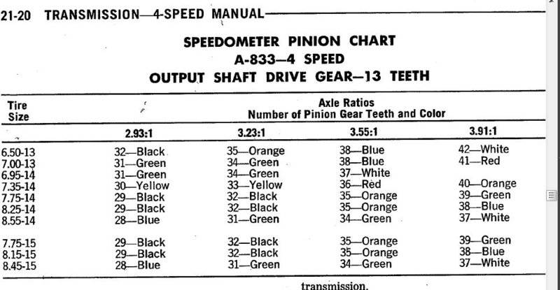

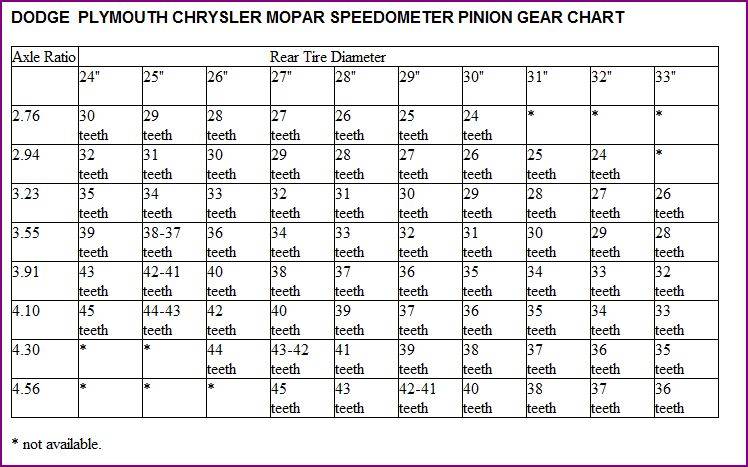

Need to know what speedo drive gear in A833 trans, with 3:54 gear in Dana 60. Going in stock 66 Hemi transmission.
What is the height of the rear tires?
Thanks,
You guys are awesome, that answers my question. Any of you guys know the winning lotto numbers as well?
My 27" BFG 255/60-15's with a 3.54 Dana had a 35 tooth gear. My speedometer was dead on with the radar speed guides that they put on some of the local streets. I hope that some help, and these charts are great because I'm going with a different gearset so I had to get the proper pinion gear.
