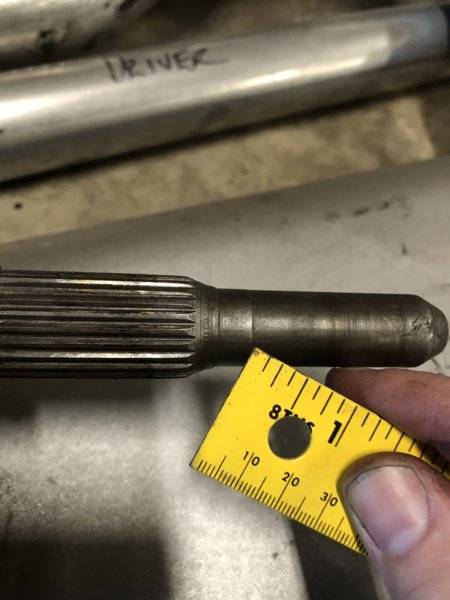

I’m wondering what people recommend for the input pilot of an 833, bearing or bushing?
My specific situation is my crank is drilled to accept an 833. I chose the bearing over the bushing from Brewers thinking that a bearing would be superior. However, the pilot shaft of my 833 will interfere with the bearing due to the little raised portion at the base of the shaft (see pic, ruler points to start of the raises portion). Brewers recommends to “dress” this area down so there is 1/8” of space between this area and the bearing.

The bronze bushing is a good bushing. The bearing sounds better (been there), but when it wears over time it fails. The bronze bushing is my first choice and can take a beating during assembly. I had a roller bearing come apart during transmission installation when the input shaft didn’t hit dead center. Just my experience. If you decide to go with the bearing you will have to dress the lip down on the shaft if your input shaft does in fact go in that far. Was the bearing fully seated in the crank?

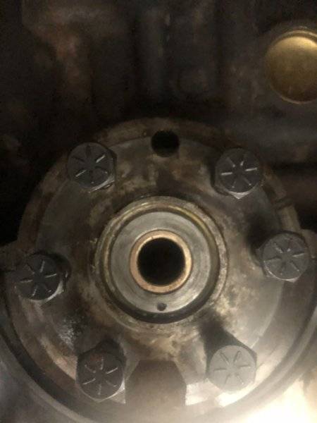

I used a puller to remove the bearing from the flange that taps into the register, and replaced it with a true Oilite bushing from McMasrer Carr for $3.00. The bushing is 1.00" od x .750" id" x 500" wide.
Froze the bushing and drove it in place of the bearing.
