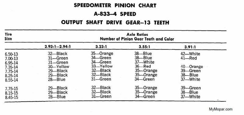

hello everyone, I sent my original 4 speed tranny from my 67GTX to Passon performance for a freshen up and just for piece of mind, this was about a year and a half ago. On sunday i took it out of the crate for the first time and noticed that he didnt return my speedo gear with the tranny.... So heres my question, which speedo gear do i need? the car is a 440-4 speed, Dana 60 with 354 gears and stock 14" factory tires and wheels, i know that they are color coded and that decides how many teeth on the gear, i really dont know why he wouldnt of returned my factory original when he serviced the 4 speed.. thanks Rich
35 teeth, 7.75X14 tires are original. F70-14 is close. Call him and tell him what happened, ask to have him send you one on the house.
And the color does NOT determine how many teeth, the colors duplicate again in the gears. They have the number molded into the gear.

From 67 SM.
thanks everyone, ill call tomorrow and ask if he can send me a #35 orange speedo gear, im betting i end up paying for one, thats ok though, i guess i should of checked the day i got it back from them, i wasnt ready to install at that time so that nice wooden crate was perfect to store it in while my resto takes shape.. i will let you guys know as soon as i know... thanks again guys, you are always there for me... Rich
