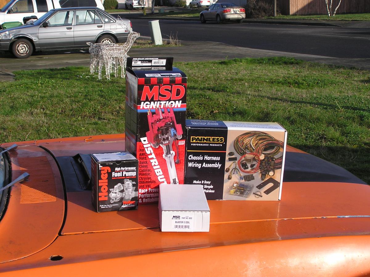

some pics...

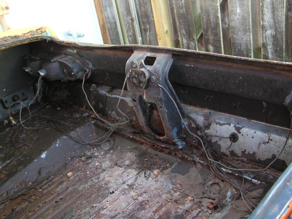

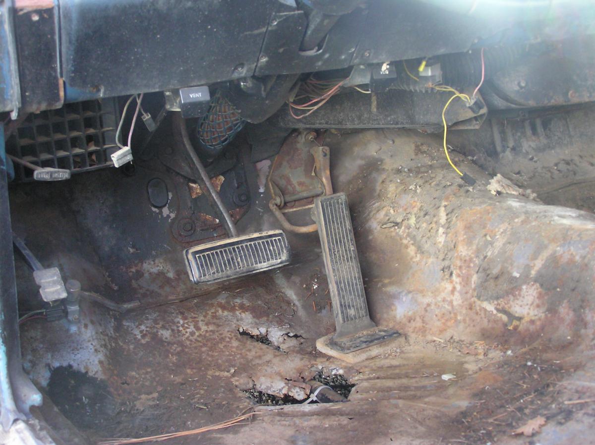

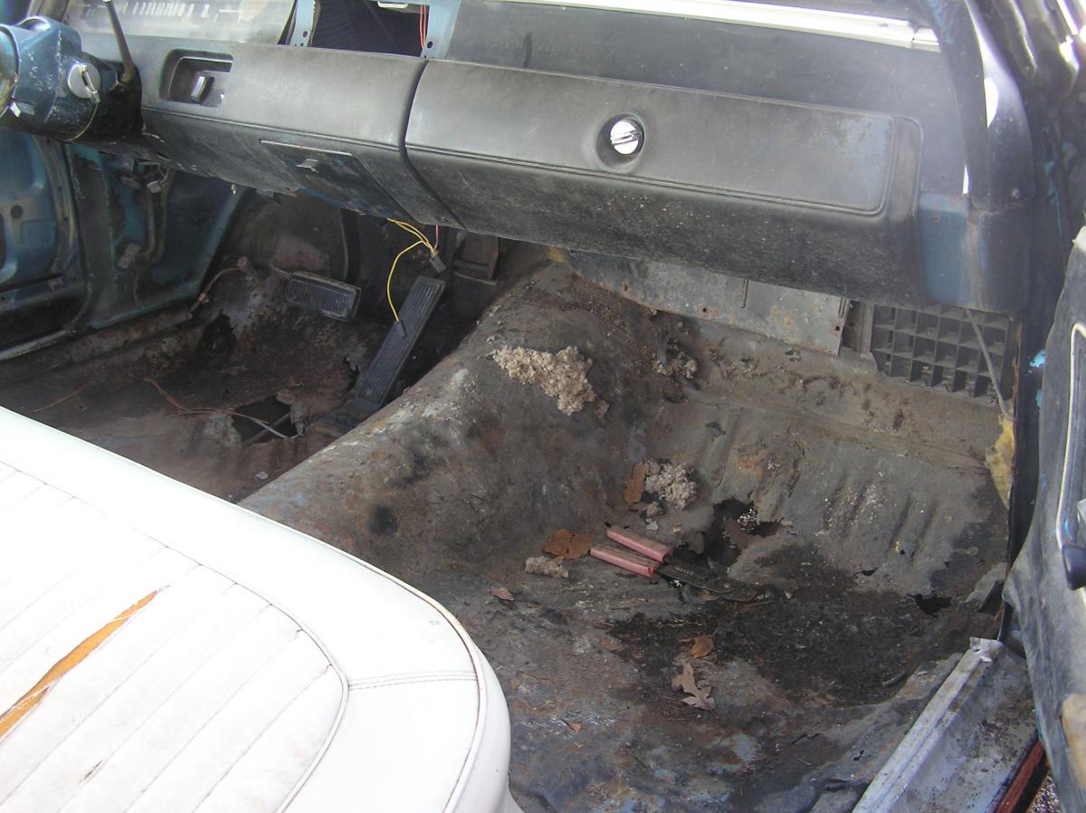

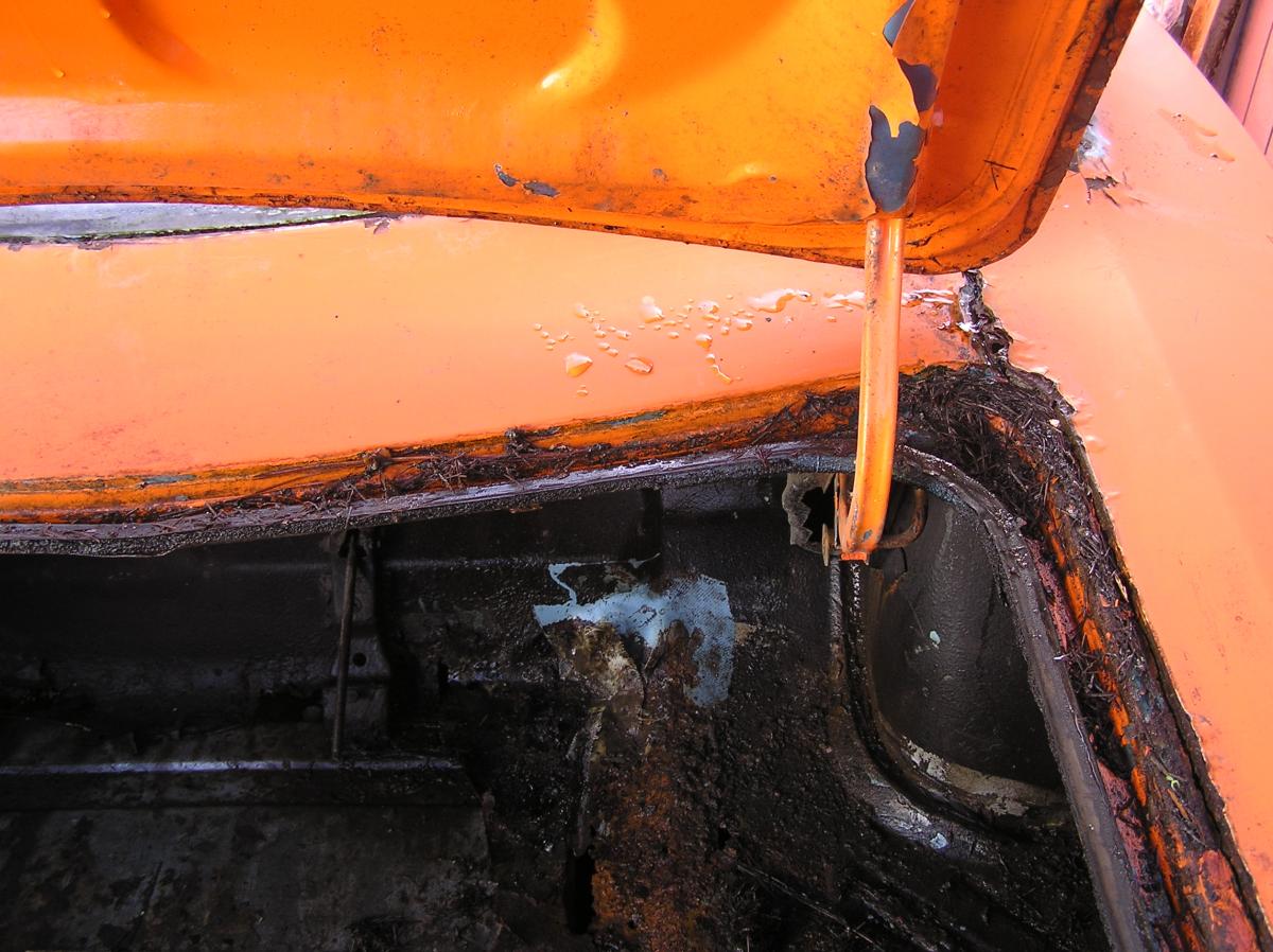

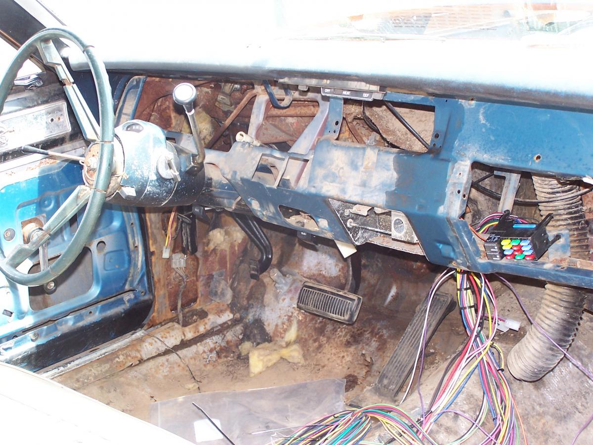

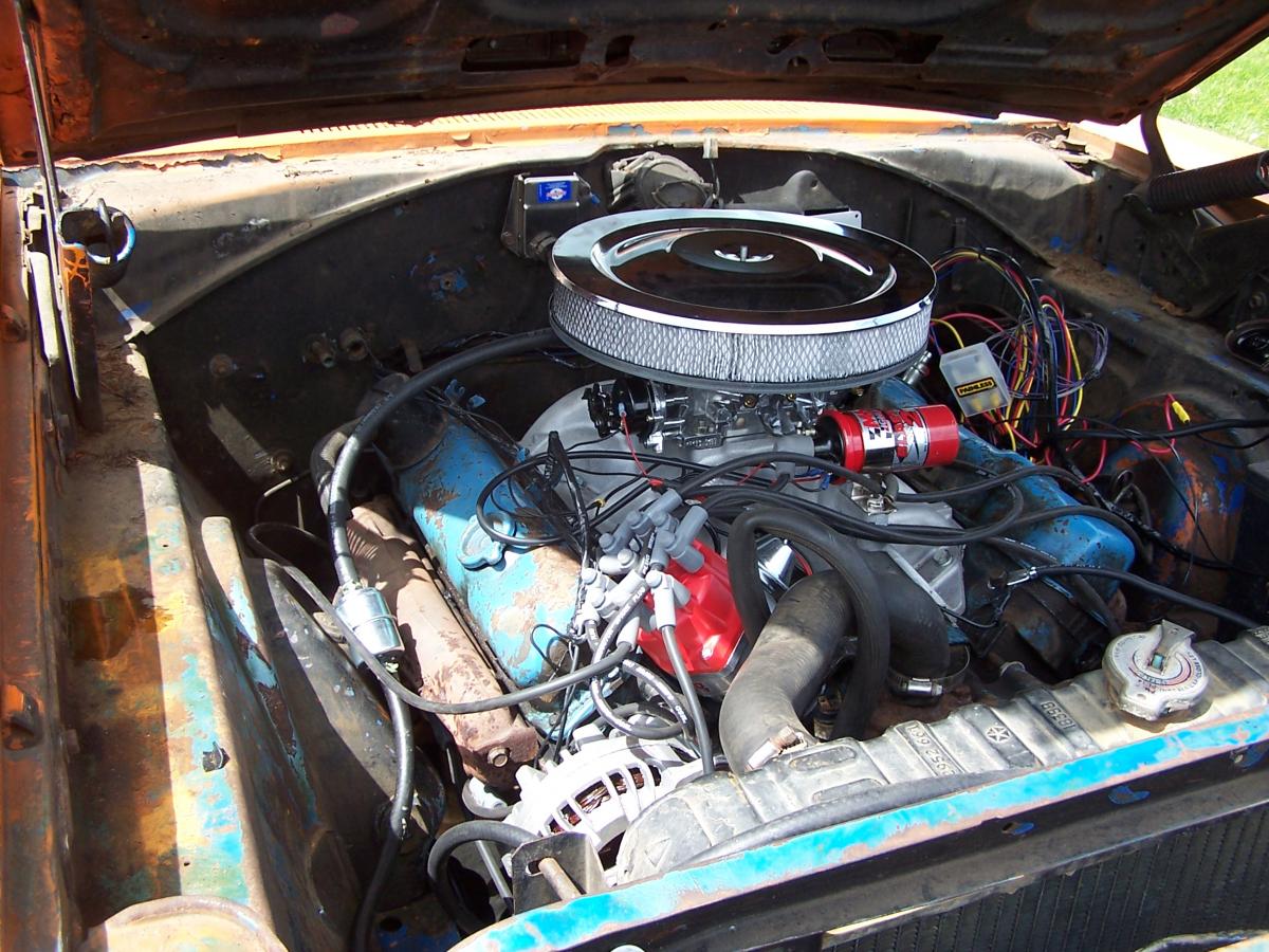

putting this together temporarily to drive for a fe weeks then it will all come back out and apart for restoration.

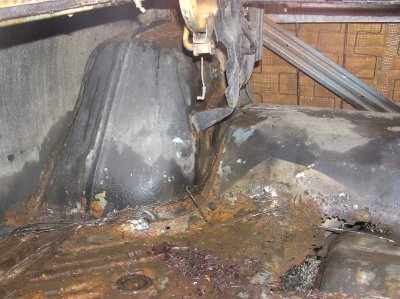

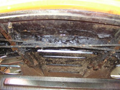

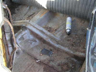

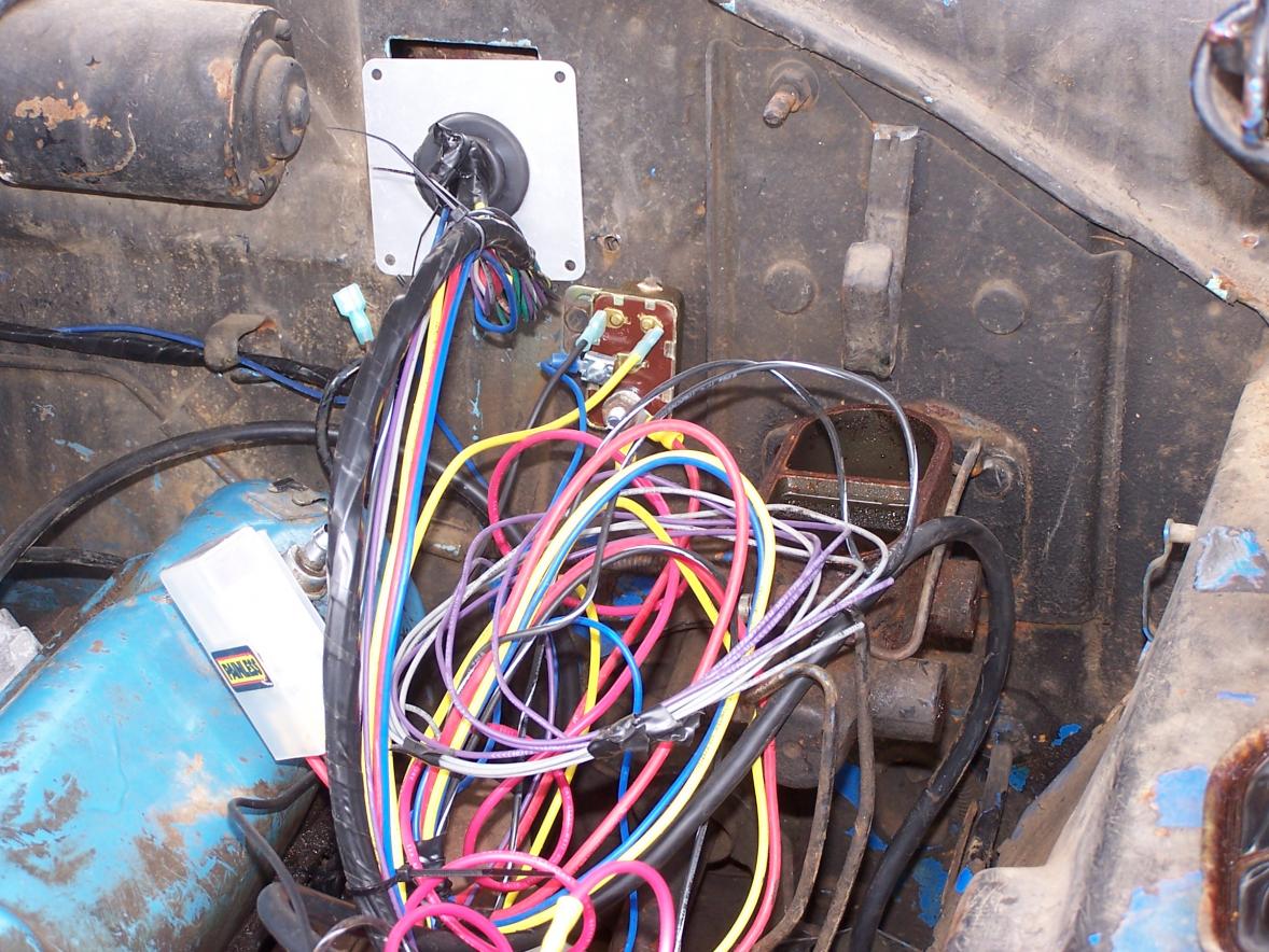

rallye dash is in the garage.. need to get it wired up soon, but the damn brakes lines are plugged.. need to take them all apart or buy a new kit for 180 shipped with all the new hardlines pre-bent

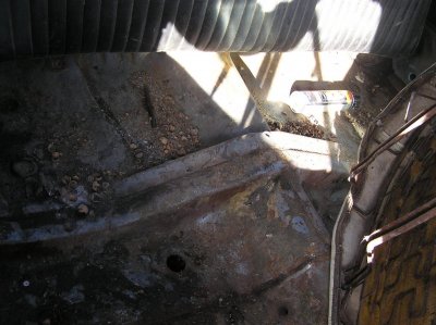

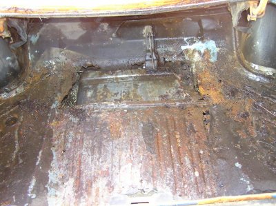

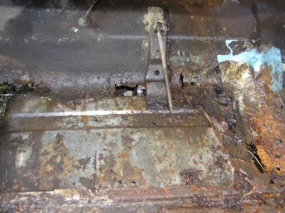

Started working on the trunk floor
http://www.forbbodiesonly.com/moparforum/vbpicgallery.php?do=view&g=1003
vbpgimage.php
vbpgimage.php
vbpgimage.php
vbpgimage.php

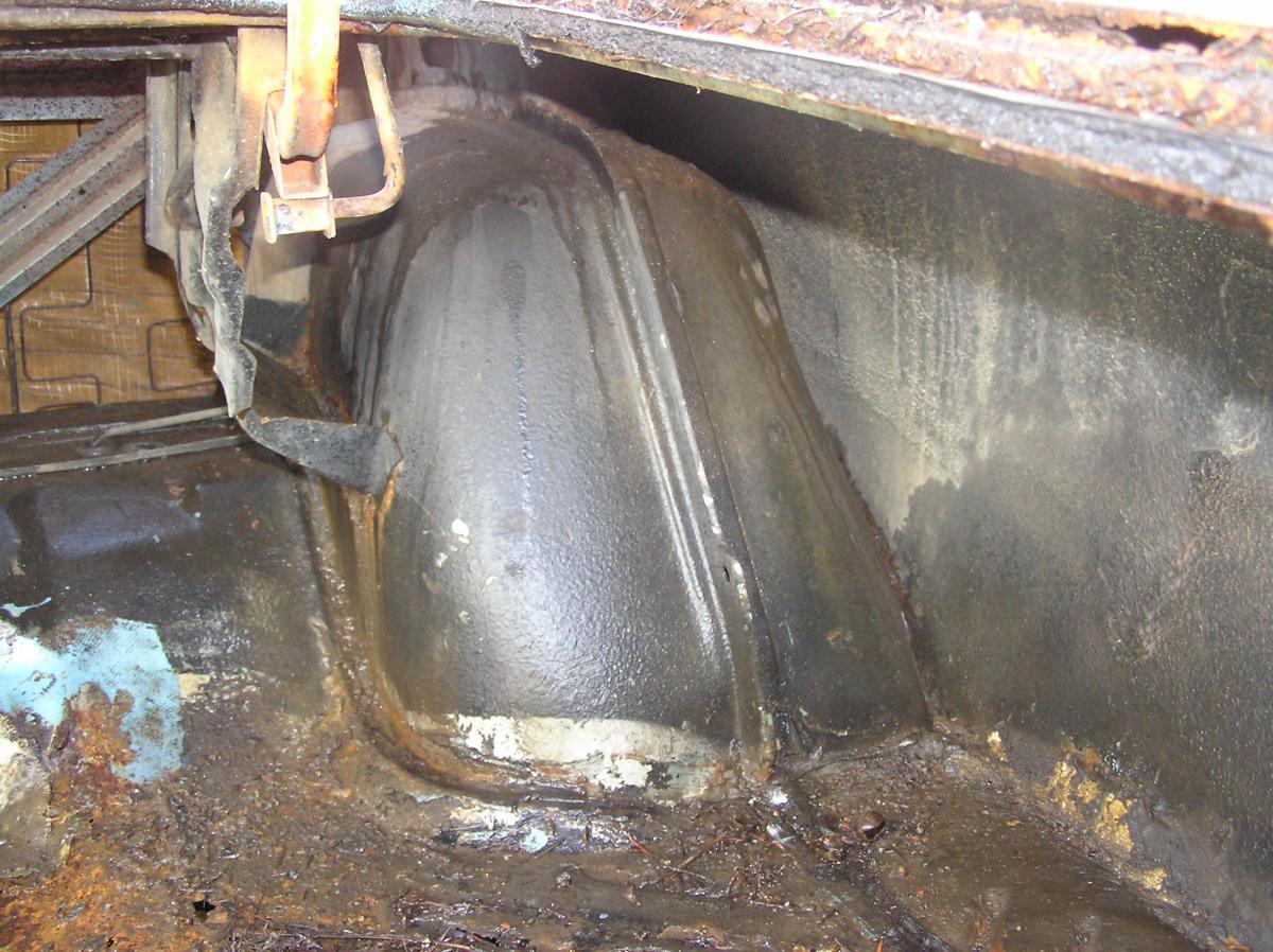

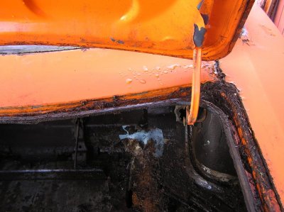

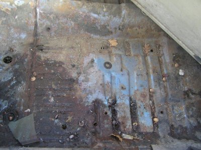

Got a few more things to do before I bring it to the welder, he does a good job and I cant afford to drop 1000 on a millermatic welder and all the accessories right now. I'll replace the drop downs when I do the quarters. Just need to be able to drive this for now.
Lookin good, maybe drill some more holes for plug welding to the frame sections.
Simulating factory spacing in my 69 RR floor I think I drilled 155 holes in my trunk floor skin.
Spaced every 2"-2 1/2"
Also a cheap buzz box and a spool of flux core would do you just fine on stuff like this.

Dave suggested more plug welds, I drilled more plug weld holes. Thx for the help Dave...
