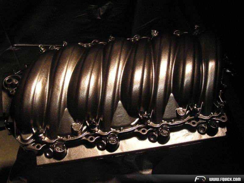

Had to replace my LS7 intake which was painted a nice Sunset Orange metallic. So I opted for the FAST 102 LSXr. Since the previous intake was painted I had to do the same to this :D
This intake was primered, sealed and then base-coated with Galaxy Grey. Then a mid-coat with apricot flake was applied.. lightly flaked.
Then 7 layers of Tangerine Kandy and then clear.
Approximately 18 hrs to port, prep and paint.

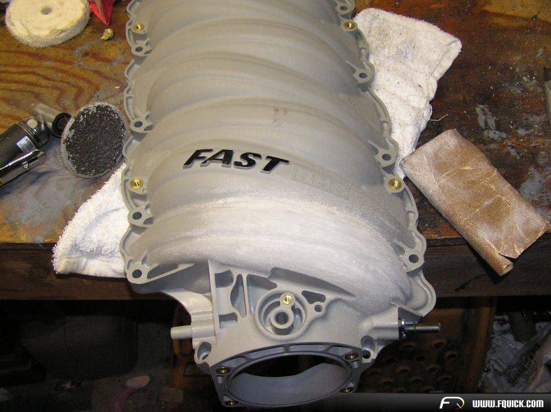

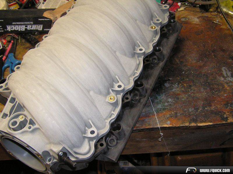

Ports are off

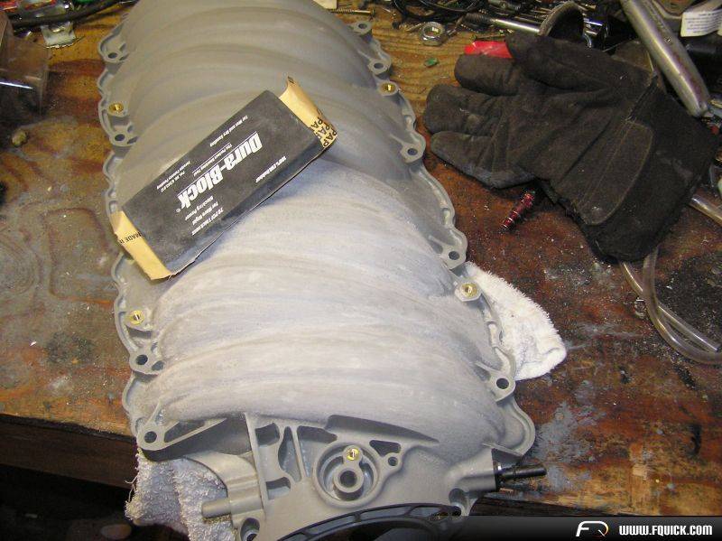

You can see how much material needs to be removed
Removing letters
!FAST LSXr
Almost ready for primer

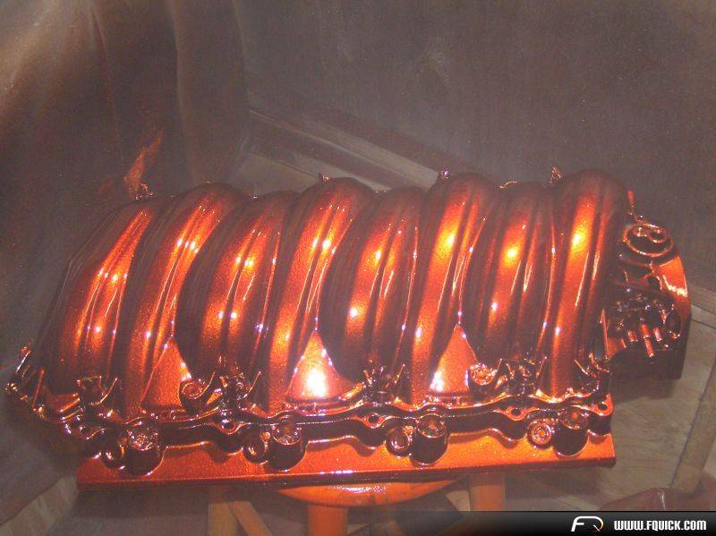

1st coat Tangerine Kandy
2nd
3rd
4th
5th
6th

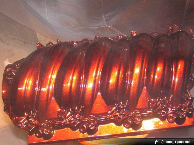

7 Coats Tangerine Kandy cleared and done
