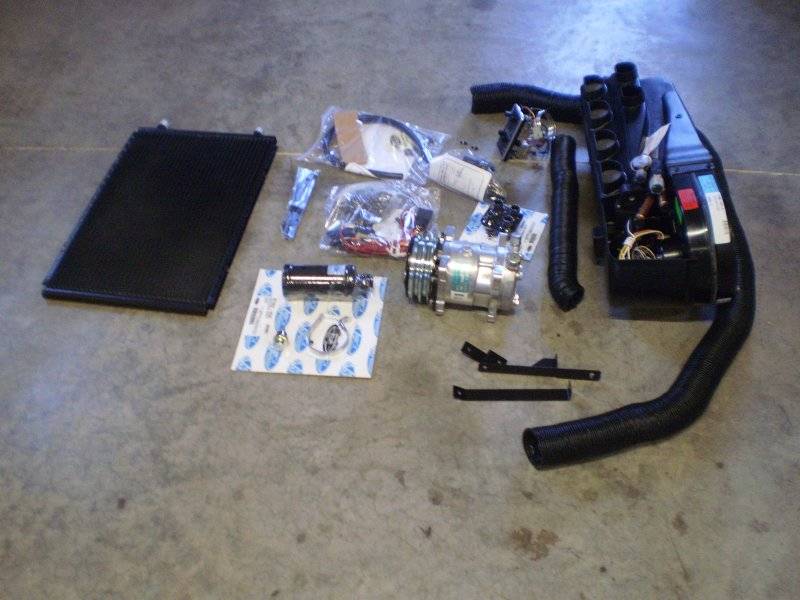

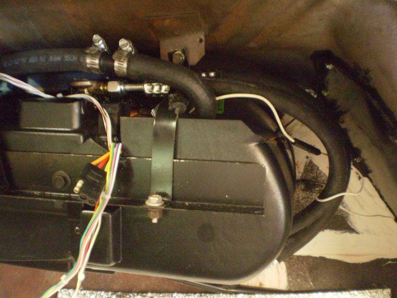

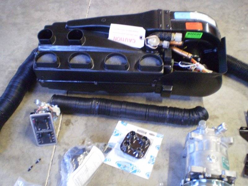

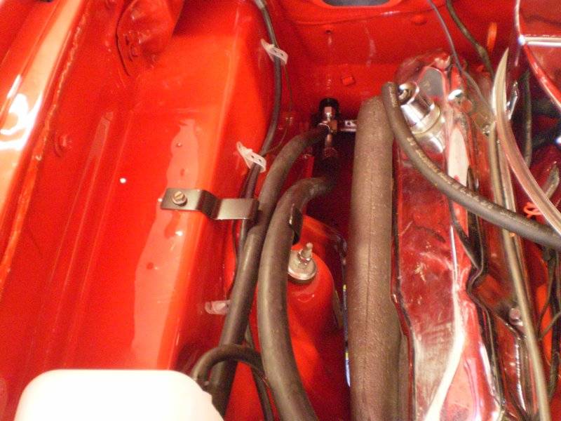

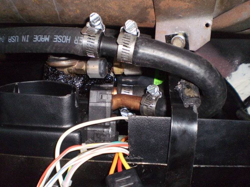

I had my aftermarket Vintage Air system in my 1964 Polara charged up yesterday. After replacing a couple of "O" rings, there were no more leaks, and the system blew cold air. It was good to see that all the electrics worked correctly. There were a lot of pieces in this jigsaw puzzle with some fabrication required, but I am glad I did it.This comes just in time, as the temperatures are supposed to be close to 30 degrees, Celsius, (95 F degrees) all this week.
Over the years, I have upgraded my old Dodge with power disc brakes, front sway bar, sub-frame connectors, cruise control, rear power antenna, AM/FM radio, power driver's seat, sequential rear turn signal lights, and now, A/C.

No, I had to noodle it out myself. VA. makes kits for 1966 and newer, but early B-bodies are different enough, that they do not offer a kit. I detailed what I had to do, on here, a couple of years ago. If you are interested in doing the same, I can supply a list of pieces I used.
