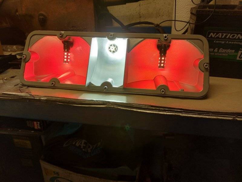

This info was originally from a Cobra Replica manufacturer who promoted them as a painless swap for 1157 tail light bulbs for better visibility. Like a lot of older cars the Cobra lights have had problems with LEDs and flashers. I’ve managed by hook or crook to get some form of LEDs in the tail lights of my old cars including my GTX, with the exception of my 66 Satellite. Despite a drawer full of various types none worked in the tail lights of the Satellite and I also tried a HD solid state flasher too, which was of no help. So I bought a pair from Amazon and stuck them in this morning and they worked great. They are a red LED so not only are they bright but they are bright red too. One thing noticed is they are substantial in heft - definitely not a cheesy piece of cheap plastic and LED lights stuck in a 1157 base.
Amazon product ASIN B01A77TV4Q
These require a flasher change ??
Other LEDs I tried in the rear of my 66 would not work, even with a new solid state HD flasher. These do work. I wouldn’t dare claim they will work with any flasher but they are looking pretty good from my experience so far. If anyone tries a pair and has problems I hope they will report that immediately.

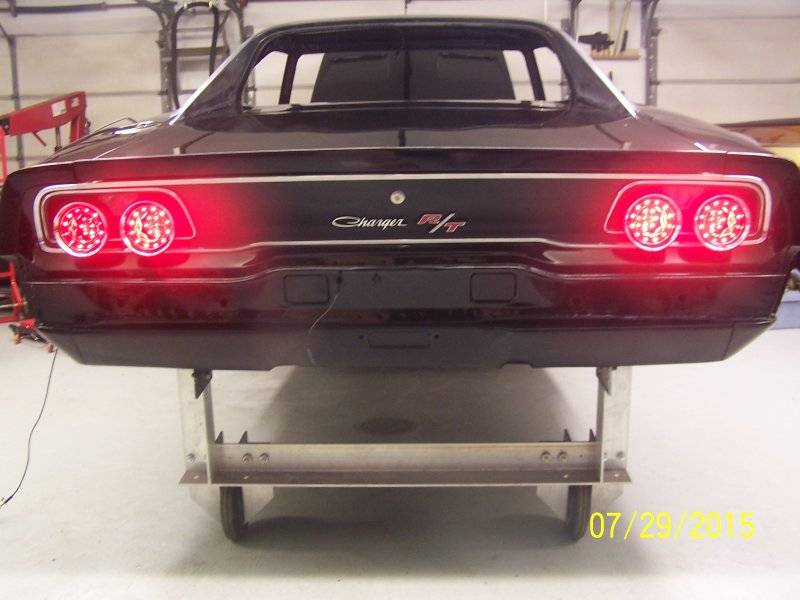

Another option -
LEDs may not have the same output pattern to reflect off the taillight housing, so the lens-fill might not be the same. Might have hot-spots.
The Sylvanias look like they might be that way, the 2nd one posted looks like it would do better.
You won't know until you try them.

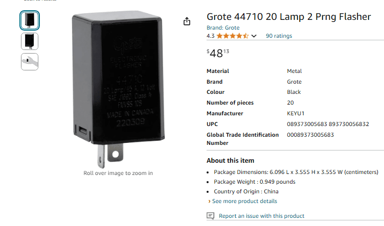

I just put a couple in the 73 Road Runner. I used Standard products flasher EFL1, worked great. I did have an issue, could not get the bulb to turn in the socket. The white housing was hitting on the plastic around the bulb housing. Had to slightly bevel the edge, I used the die grinder not the box cutter in the picture.

Hey Fran how did these LEDs work out? Did you have to change your flasher? Thanks Dave
Flasher is on my desk, waiting for Mr. procrastinator to go look under dash and find flasher.
Just a side note . . .
when you change to LED bulbs, since they have a much smaller current draw, your flashers might no longer work properly ! !
By the way . . . this could also cause the turn signals to not flash too ( probably just light and stay on )
Simple solution . . .
look for an Electronic Flasher to replace the original stock flasher and they will work. ( kinda important too )
