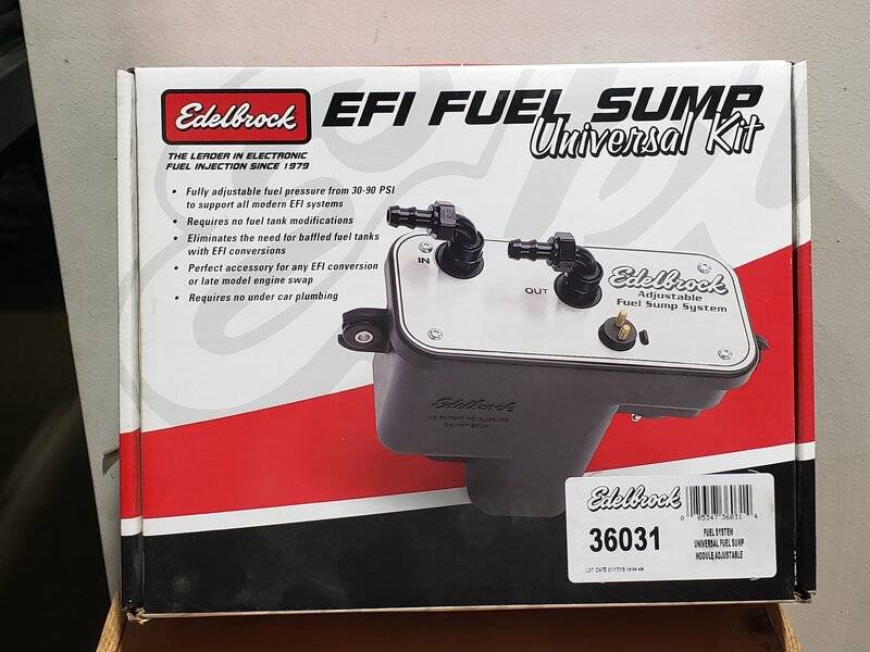

Received this as a gift from my shop guys. They keep busting my balls to install it. I show it here only because it's been mentioned a few times. Thoughts on the externally mounted fuel sump rather than a new tank with integral pump? All the other parts come with the package. If I do decide to pull the trigger perhaps I'll keep a few spare parts on hand to address the concerns some here have mentioned about being stranded due to component failure?
View attachment 1262434 View attachment 1262435
Don't do it. These sumps have little fuel, get hot sitting in the engine compartment, and actually add complexity. I have heard many with issues that have tried them.
I believe strongly that if you are going to do fuel injection, do it right. Ditch the external fuel sump and get a fuel tank with an internally mounted pump. Along with that, route a supply and return line.
