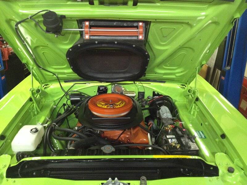

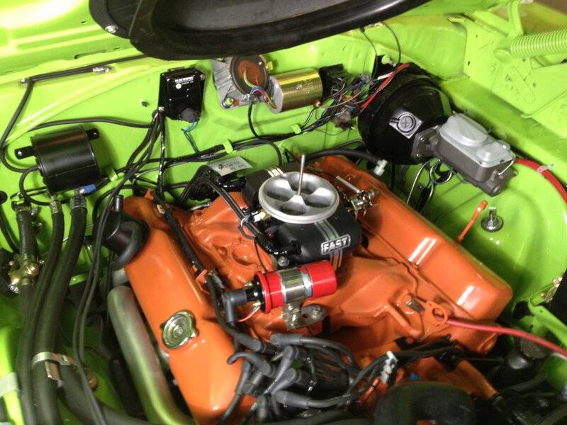

My FAST system instructions wanted me to drill a huge hole in my firewall to pass through the cable end and place the ECU in the car. No way I wanted to do that, so I also deconstructed their wiring harness. I wanted the car to look as reasonably stock looking as possible, so I then routed wires with my stock wiring and wrapped them in the old style friction tape. This is the under hood result for my now air conditioned and fuel injected 70 Road Runner. It took some time, but I think it was worth it.
Here is a shot without the air cleaner:
That looks great !
Nice job Hawk.
I tried to hide the wiring too but didn't do as sanitary a job as you did! My "mistake" was trying to integrate the FI harness into another aftermarket harness during a complete re-wire of the whole car. After re-doing the entire thing over TWICE for various reasons, I needed to stop futzing around with it. I'm sure I could go back and re-do it again a third time but so far I've refrained.
