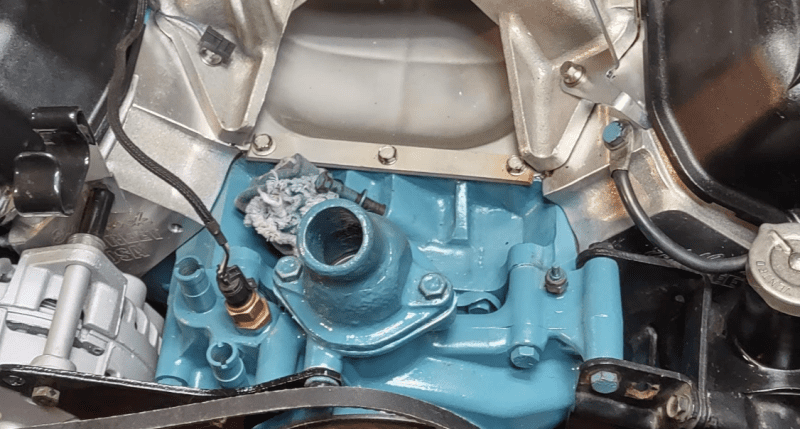

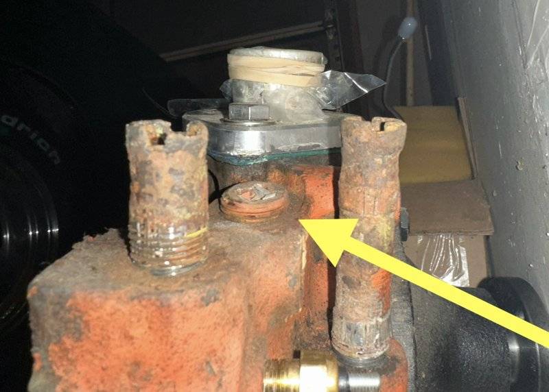

No a Chrylser big block intake manifold is dry.
Look for a pipe plug in the water pump housing or get a thermostat housing adapter with a water port opening.

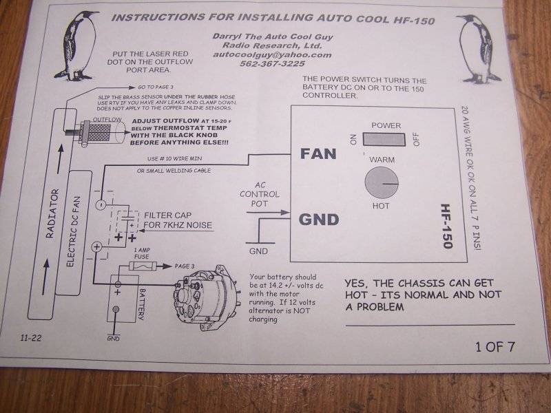

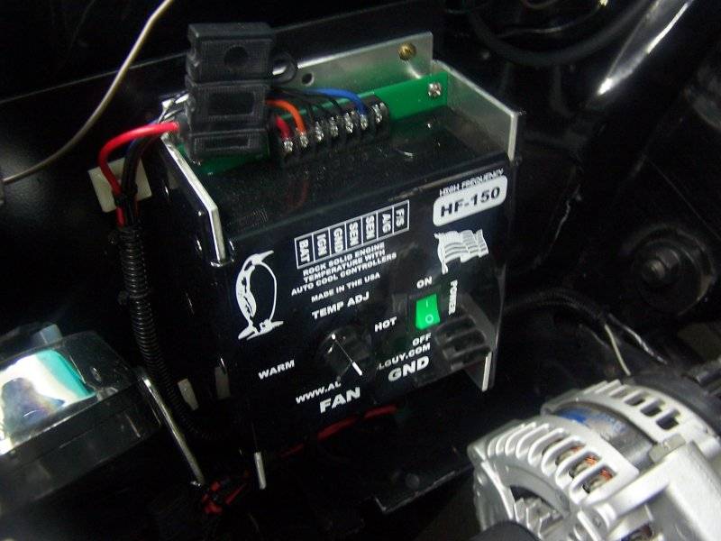

You may want to look into installing a controller like I did to control my dual electric fans. I put dual puller fans on my 6.1 build in my 68 Charger. I installed the relays and wiring but could not stand the constant roar of those fans. I then found Darryl the Auto Cool Guy. He set me up with his system that eliminates the relays and you get everything you need to make those fans work exactly like the new cars do where the fans ramp up and down as needed. His system has the temp sensor on the lower radiator hose for controlling the fan start up. If you have AC, it will activate the fans as well. I absolutely love it.
Give him a call. Here is a couple pics. One has his email address and Phone number. The other has the Controller I bought.
Drill and tap a new hole in the water pump housing
I put my fan temp switch in the place indicated in post #9 - works fine.
