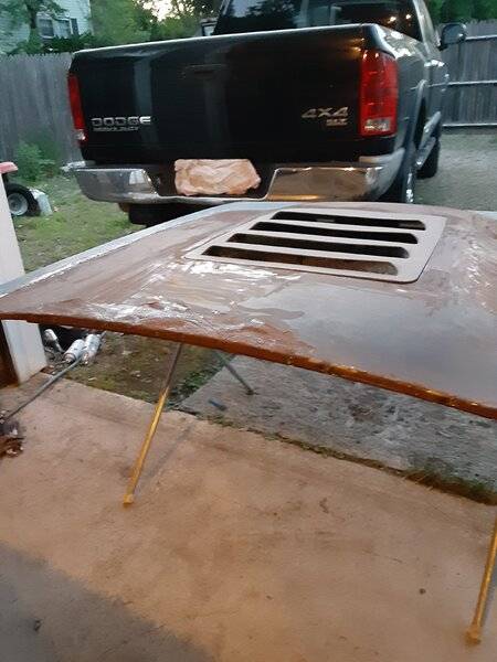

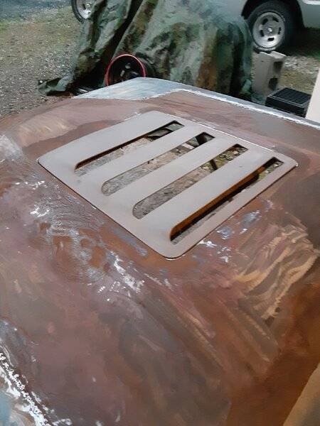

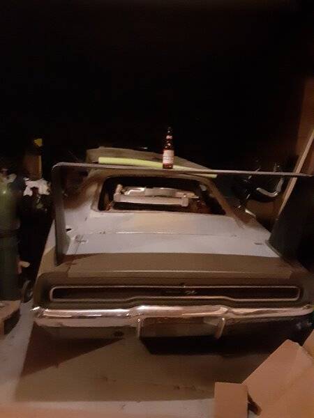

This original Daytona wing has a new purpose!

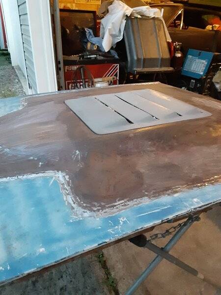

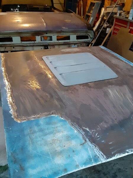

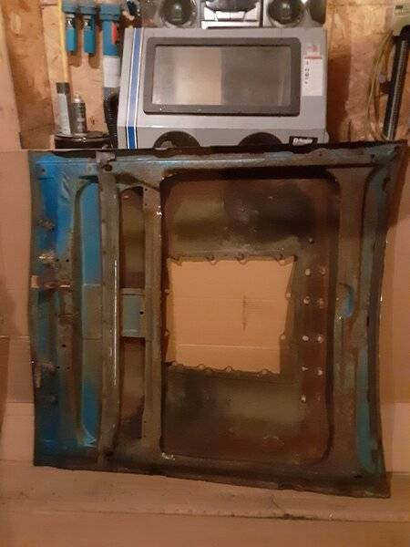

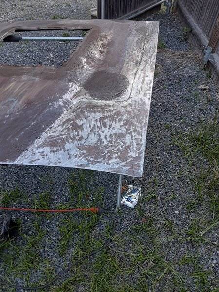

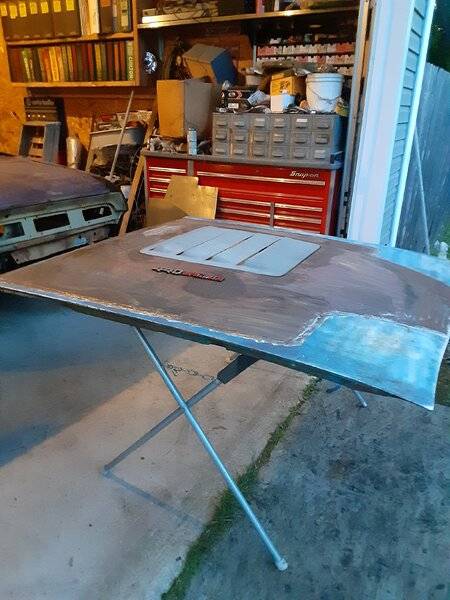

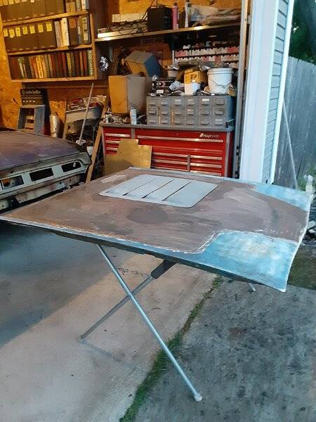

This is a picture of the underside of the new hood for the stock car. I cut out and welded up the stamped gussets of a standard 70 Charger hood that interfere with the latch tray on a Daytona.

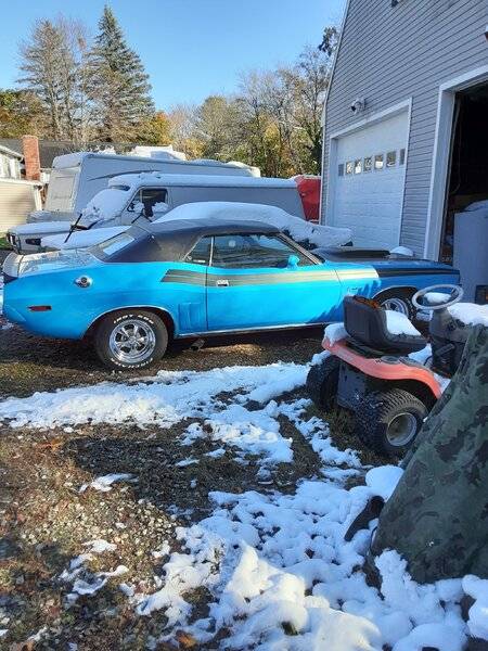

Yes,that's my wife's Challenger convertible, it's an original plum crazy purple car with a white top and interior. It's an L code 383 automatic car. We bought it from the original owner who bought it new when he was 18 years old. He wanted an R/T, but the insurance company said no, so he checked off the boxes for a rallye dash, a sport hood and dual exhaust. After he got the car home, he added a new cam lifters and valve springs, and a pair of closed chambered 67 440 heads and he had his insurance beater almost R/T.
