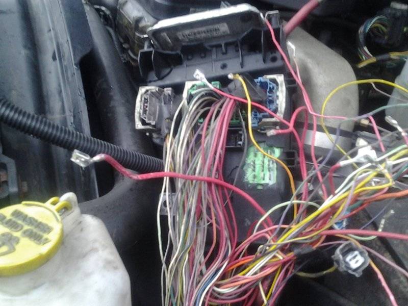

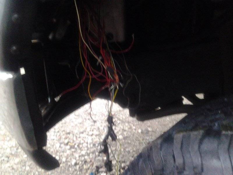

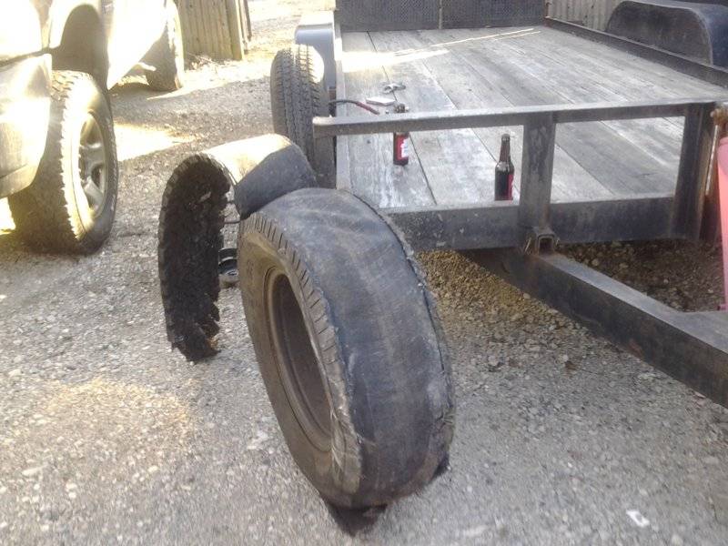

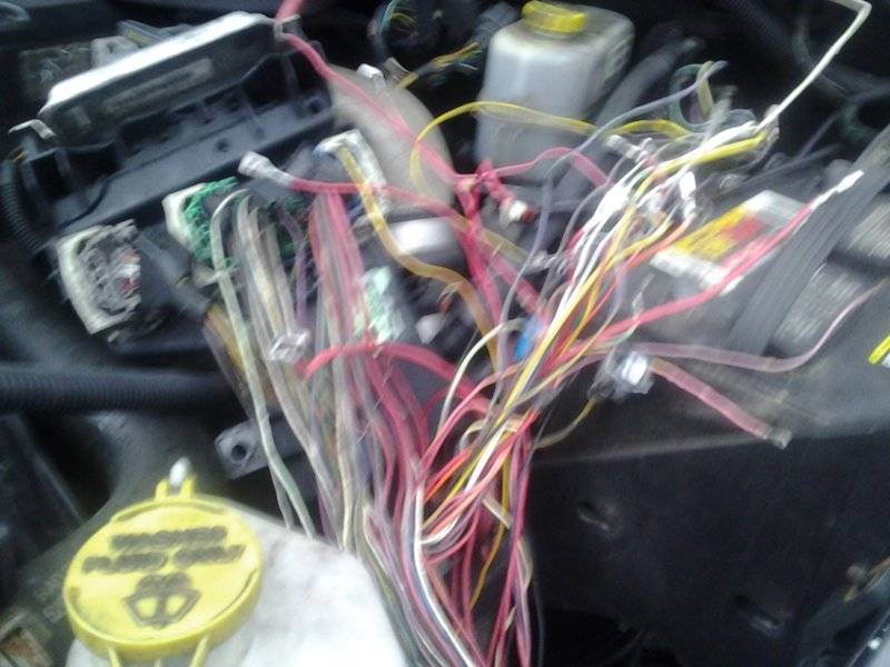

I made the mistake of taking my new wheels and tires off my truck for the winter, and putting the old ones back on it,and it cost me dearly. More pics. View attachment 736647 View attachment 736648 View attachment 736650 View attachment 736651
Hey Pete... Luckily there was no peril to you when the tire blew... Like your new truck..... Dig that Daytona project....
Thanks Troy, I was lucky that the guy who was coming up on my left saw the tire blow and backed off and let me come over because it was going that way on its own, there was no control, all I could do was try to get it stopped without hitting anything or anyone! I had it towed to the electrical shop on Saturday, so hopefully it will be running again soon. I am looking forward to seeing your new aero project progress. Such a great find with such cool history!

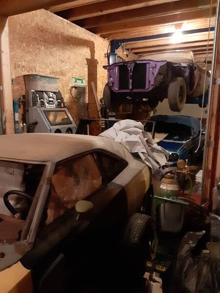

I got out in the garage tonight, have to move some stuff around. The stock car is one of the things that I have to move. My friend wants to use the lift to put the engine in his 69 383 4 speed Dart GTS.

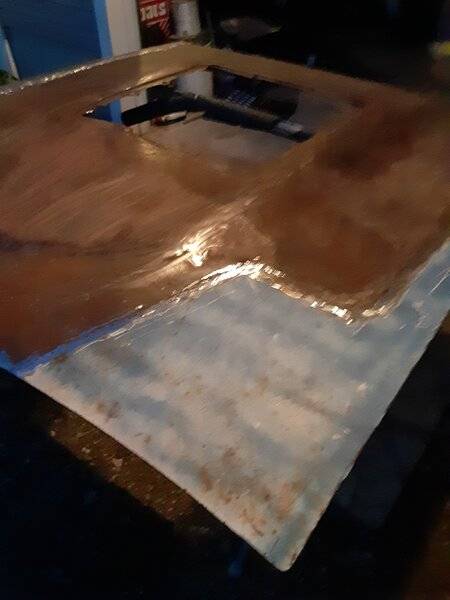

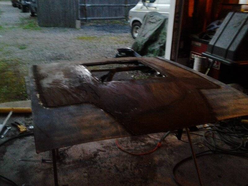

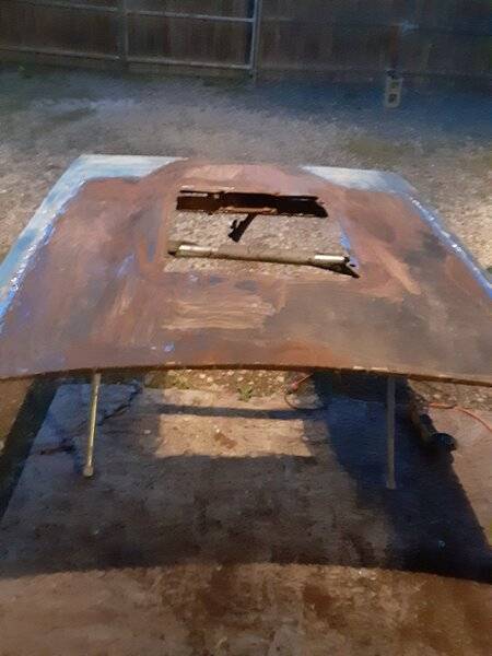

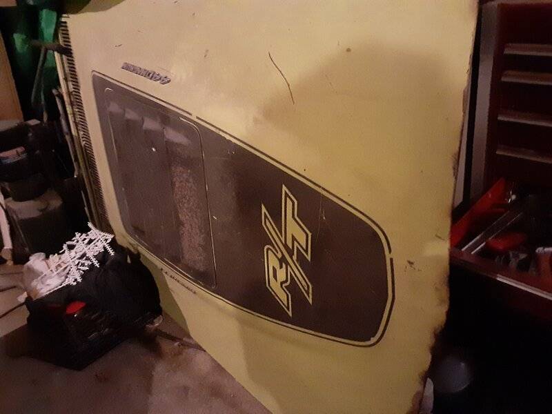

I just spent the last 6 hours fabricating the new custom hood for the Daytona stock car. I grafted a 70 Charger hood together with a damaged 71 Charger R / T hood to come up with this one off Charger hood for the racecar! I am pretty happy with the results!

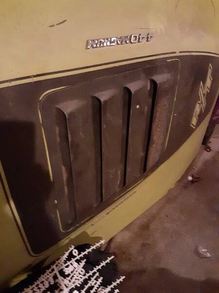

The hood will have the louvered 71 Charger insert, without the underside block off plate. The hood will be functional and will help dissapate heat from under the hood. I think it will look really cool with the louvered bulge hood and the fender scoops!

Great work on that hood.
I spelled it that way on purpose, it gets attention! What redneck wouldn't want to drive around on public streets in a Daytona stock car! I am pleased with the way the hood came out. I like making things that no one else has ever built, and I like doing it with all factory pieces!

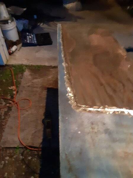

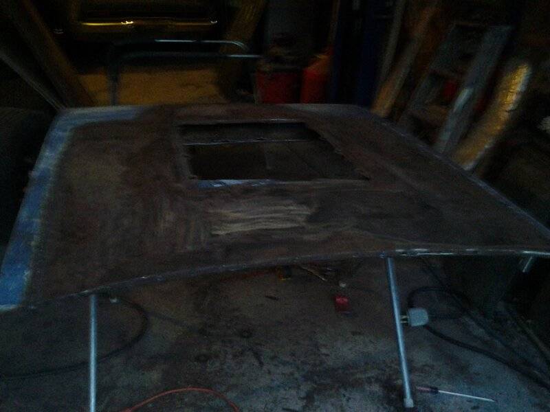

I started grinding down the welds on the new hood for the stock car. I followed Ian Rousells instructions of grinding only the welds,and not heating up the two surfaces of the two hoods that are being mated together and what he says is true. There was very little heat and distortion of the hoods.
