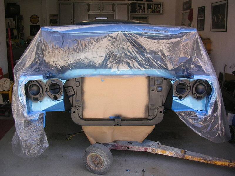

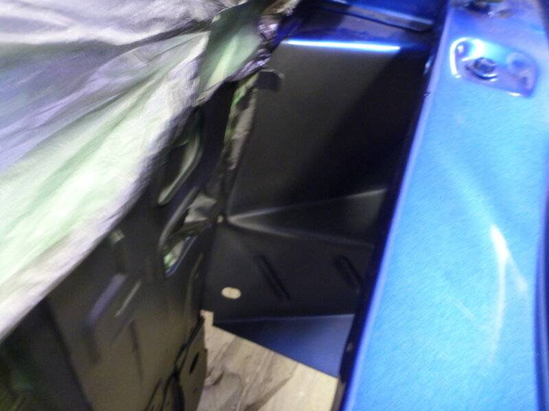

Yes like any B-body unless you have a black car. This is how I did mine

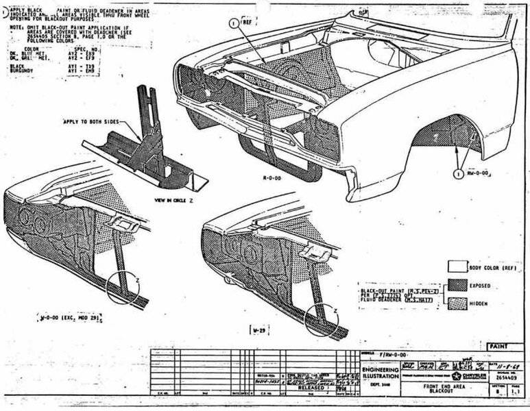

Richard Ehrenberg says all cars but Black and Dark Blue. They missed my original paint QQ1 Electric Blue wagon when it went down the line at Lynch Rd.

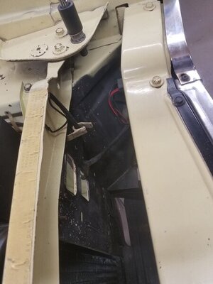

Dark colours, tx9, maybe Jamaica blue, maybe another I’m overlooking didn’t get it. Might have been hit and miss depending on qaqc and how lazy the line worker was. I have a Q5 car and it was done.
Depending on your restoration and application (ie: what you’re going for) you may find it easier to black out the whole front end, taping and masking wise. At the factory they weren’t very mindful about things like overspray etc, whereas you may be, especially if just cost you an arm and a leg.
I also have a yellow car where that colour sticks out like a sore thumb so I did it all behind the grill and in front of the rad

Do it right and block it out regardless of body color. We have had discussions on FABO about it and there were TX9 cars with the paint. It was like thinned undercoating shot through a "weed sprayer" type wand from a pit under the assembly line. Depending on who was working, all cars got it or most got it depending who was doing the work. The overspray shows on the undersides of the surfaces.

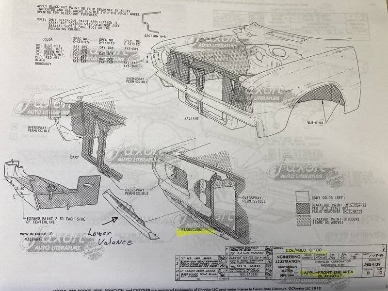

Described as "paint of fluid deadener" (thinned undercoat or sound deadener)
