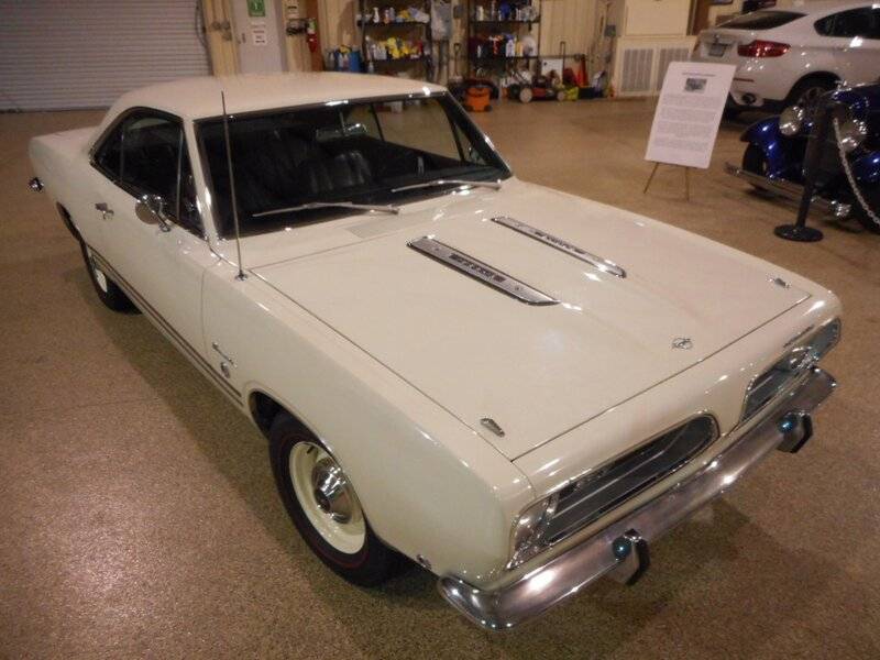

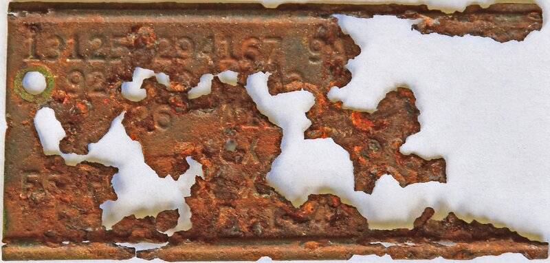

Not to mention painted with a shitty brush..
Do you feel the tag is not original also? I looked past the horse hairs in the brushed on paint but the tag appears to have rust pits, I didn't suspect it as being a repop.

The first sign is the corner of the tag has never been bent. The factory attached the tag at one corner then bent it up to paint afterwards pushed it down and fastened the other corner with an unpainted screw.
It's missing any sign of inspection stamps or other usual defect/dents.
They guessed at a lot of things.....
There are people out there that pay attention to this ****.
