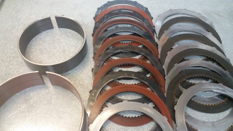

Ok mines apart. Here's what Alto front clutches, stock rear clutches, and red line band look like after 420 passes. Aprox 900hp@3350#.
Doug
