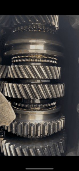

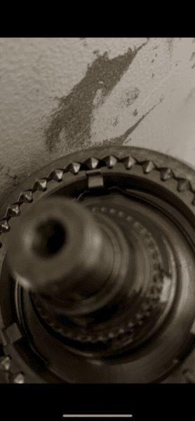

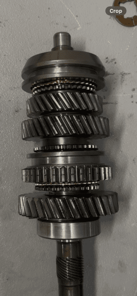

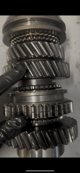

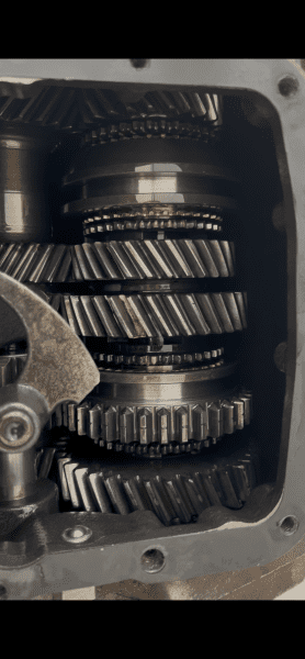

Hello everyone. I have a couple of things I want to touch on. Currently I am having issues with my 69 a833 4 speed getting into second gear. Under hard acceleration I can occasionally get it to get into gear. Something to mention is, sometimes is feels like a “dead space” almost as if no gear is there. 1st, 3rd, and 4th gear work fine. I have played with my linkage and it shifts perfectly into every gear with the car off and I have confirmed I am getting full throw and actuation of each gear by physically checking under the car. I have pushed the car in 2nd gear with the car off to see if it was even gear and can confirm it is. I recently refreshed the transmission and did all the seals and bearings as well as roller bearing etc…
My biggest culprits as to why I am not getting second gear are I am using cheap stp 75w90, bad synchro gear (Although it looked very clean inside and the teeth are in very good condition), my z bar does not have the protrusion for the clutch rod so I ran a bolt and lock nut through it. Although that wouldn’t make sense because I get every other gear.
What do you guys think? This was my first time working on a a833. Did I leave something out or miss something?
