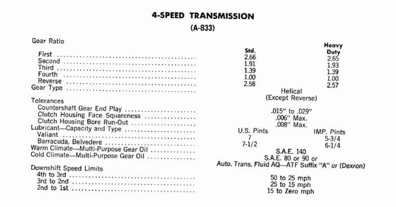

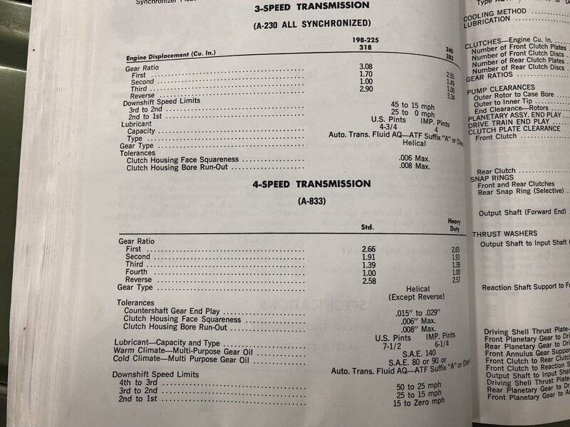

From the 1970 Plymouth FSM (section 21 page 118)
Here’s the 1970 dodge manual, notice the 3 speed synchronized calls for ATF. The 4 speed calls for either.

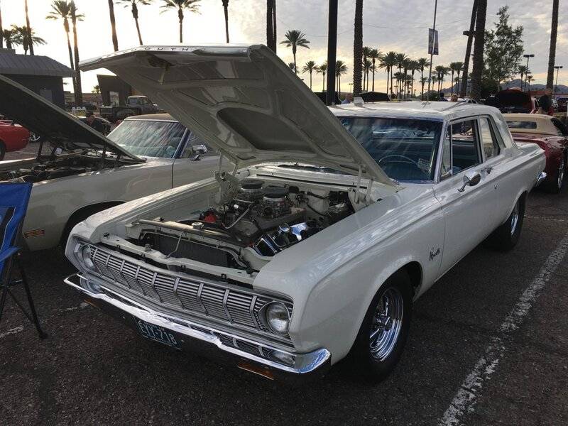

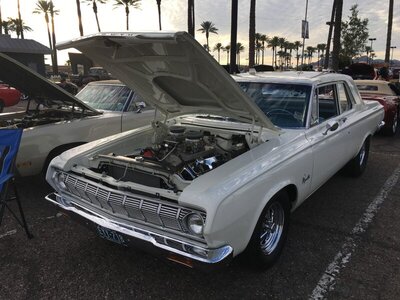

As some of you know I just completed a tranny swap in my 64 Hemi Savoy. Automatic to 4 timer. In talking to Brewers numerous times during the project the subject came up about fluid for my freshly built 833 and their recommendation was straight dura lube and if you had a slight rub thru the synchros during break in cut it with a pint of ATF. Do not think its necessary to make comments like R413 made when we are trying to help each other out.
