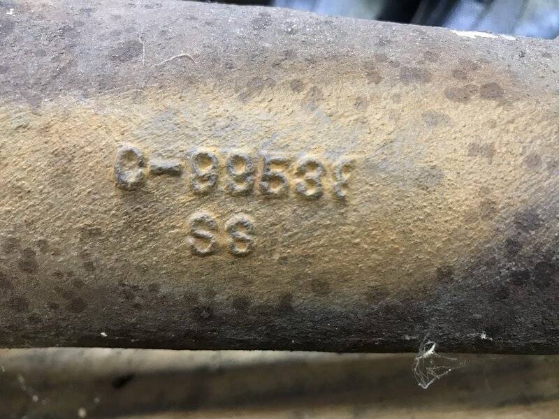

It is a cast iron case with the long tailshaft that has both the B and E body shifter mounting locations.
The casting number on the tailshaft is C-99538.

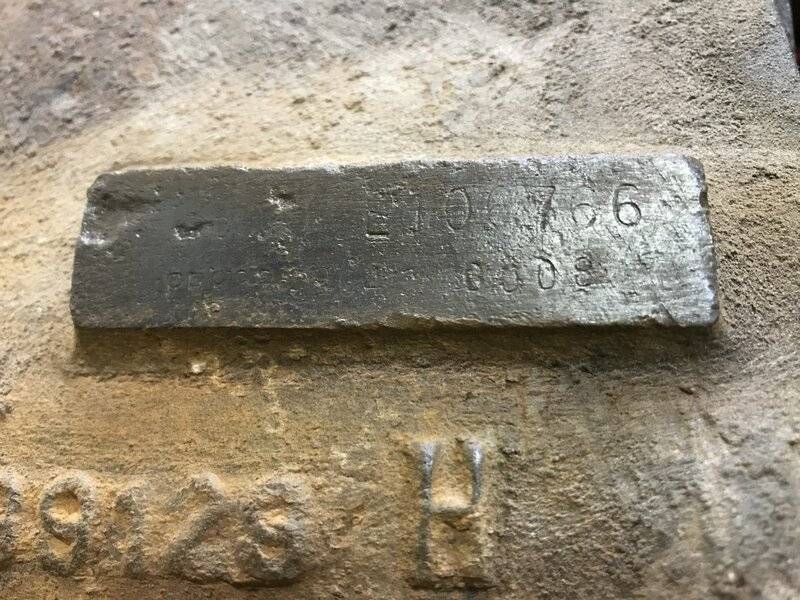

The only numbers on the machined pad that I can make out are E106766.
That appears to be part of the VIN.
Is there a number in front of this string like 0E106766?
There is not any numbers or letters in front of the "E". Below is a picture of the pad, the best one that I could get. There are other smaller numbers which I think are the date code, but I can't make all of the numbers out on them.

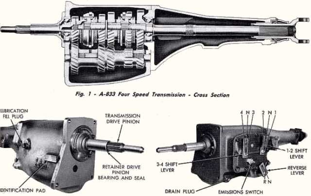

Do you know the position of the levers on the side to get to first gear? I don't have a shifter to bolt to it to get it into first gear.
I just found the below diagram in another post. So I guess this answers my question on the shift lever positions.
Mostly I have been able to find from what I think the numbers are Manufactured Sept8 1969 (1970 Model year Trans) the 8th one built that day Built in LA.

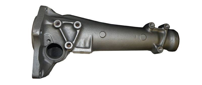

Check your tail housing is it possable that the tail housing is a 99539?
E-Body Tailhousings
For the remainder of 1970 to the end of production for the A-833, the tailhousing took casting number C-99539. This tailhousing was used in B- and E-Body cars, trucks, and vans until 1986. It can be used in any B- or E-Body car from 1964 and on with the proper crossmember and mount. These are not necessarily the factory configuration that is needed to make it work.
Thanks for the help on the build date.
I looked again at the tailhousing. I think you are correct that the casting number is 99539. Part of the last digit is missing, but looking at it in the picture below, I think it is a 9.
