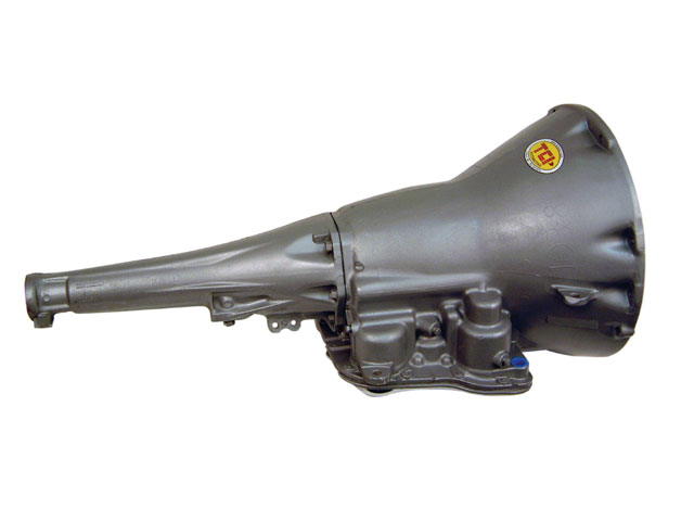

here's a Chrysler 727 automatic....

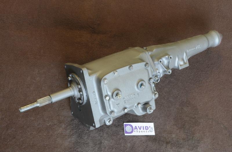

and a 833 four speed

You have a 727. A-833 is the manual four speed.

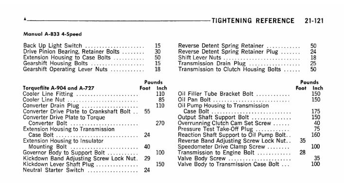

Here's the factory tightening reference - 150 INCH pounds for the pan.
Wow, that might have been bad if I tightened it to the wrong spec, thanks for all the help, my next question is that there was a puddle of tranny fluid under the car could it possibly only come from the lose bolts? Or would you think that it's a cracked seal.
