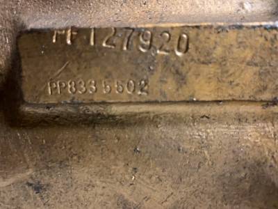

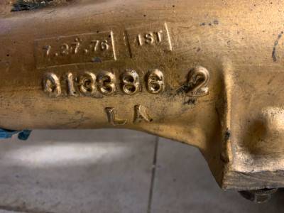

Hello all, I am looking at purchasing a used A833 overdrive trans here in Canada. I have a couple of pictures of ID numbers, but I'm not quite sure how to go about looking for the associated information. Can someone please tell me how I can decipher these numbers? Thank you very much.
Based on the number 5502
The trans was built on 22 Aug 1976 for a 1977 model year vehicle
I cant decipher the vin stamp's first 2 letters
I'm sure some one on her will be able to.
Frank
Frank
A little more research it COULD have been a Plymouth Fury VIN first letters possibly "PF"
