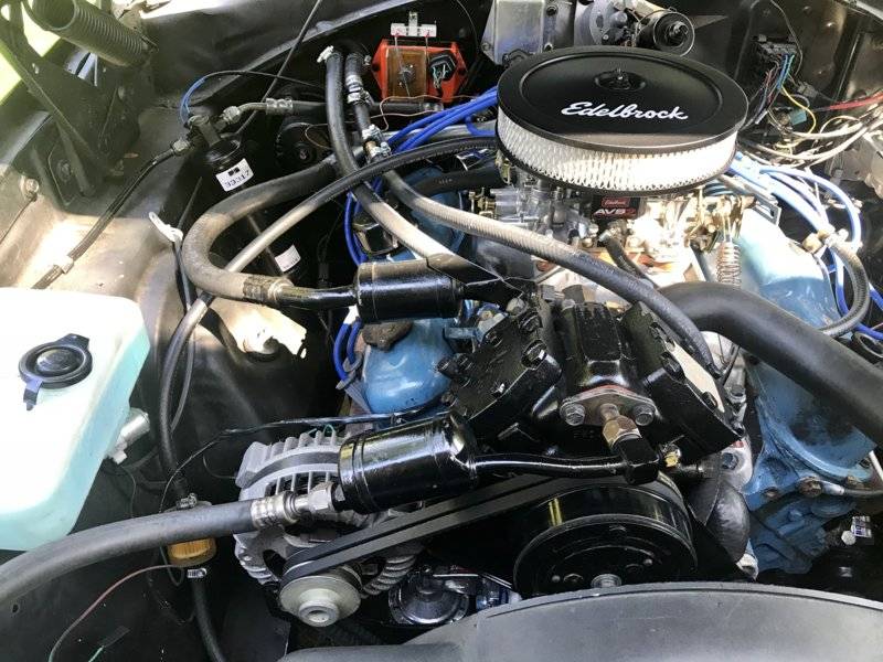

I finished the complete replacement of my AC system and it cools great! I bought a can of AC Pro from Walmart and that’s all I used to charge it.
How much idle increase do you guys use with AC on in the summer? I know the clutch engages the compressor thus lowering rpm, but mine really shakes and the 2 belts from the alternator to the AC bounces up and down about an inch when ac is on. Is that normal too? Smoothes out with increased rpm.
750 year round. There is a detectable bump/click when it cycles, but not significant.
View attachment 603184 I finished the complete replacement of my AC system and it cools great! I bought a can of AC Pro from Walmart and that’s all I used to charge it.
I'm confused. How many ounces of refrigerant did you use? How long did you evacuate the system?
Mike
PS: You obviously need a big stroker motor to carry that load!!!!!!!!!
Don’t know the ounces, but filled it till the gauge was in the green/full zone.
Did not evacuate. All new parts. Is it required?
AC was on the 318 2 barrel. Swapped for a 360 4 barrel. Would think thats enough engine.

Thanks all. I’ll chalk up the $30 ac can as a “test” purchase and take it to a pro.

Yes. New compressor, evap, dryer, condenser, expansion valve, etc. only saved the 2 hoses and cleaned them with ac cleaner.
