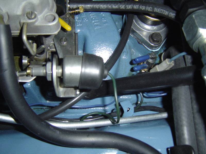

Its not a matter of having enough engine, its that there is more demand put on the engine at idle, so, a idle solenoid is used on stock applications to increase the idle speed when the AC is on by actuating the plunger the throttle shaft is not allowed to return to regular idle position. Here is a picture of an AC idle solenoid on my 73 340 RR, this is on a thermoquad carb, and is attached to the AC circuit, so it engages when the AC is switched on.

My unmolested 73 318-2 A/C car does not have an A/C idle solenoid (nor does it have a clutch fan or coolant reservoir).
However, the FSM lists different idle speed settings for A/C and non- A/C 318 cars.

I have all three plus a 28" radiator, yes I said 28" radiator, that was factory for the max cool options on the 340.
FSM spec is different for AC and non AC cars.
I want to say my 73 calls for 50 RPM increase.
Mine is at 700 and is fine with the clutch not engaged, but does drop 50.
I've been harvesting solenoids and hook up should be easy (just tap the clutch lead) but mounting looks like it's going to be fun.
Plus it's kind of hard to tell the diff between an AC solenoid and an idle stop.
