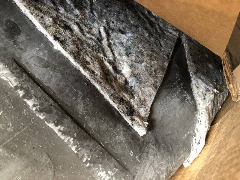

I just got ACC carpet with the mass backer for my 62, didn't come with jute.
I don't recall if you could add the jute with the mass backer, but I don't see the need.
I like it way more better than just the jute, and wish I had ordered it for my 64.
On another note, the carpet with the mass backer was much longer and wider, by a long shot.

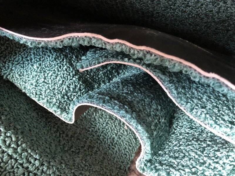

Update: cutting the edges to fit, just carpet and thick rubber backing, cutting holes for inner seatbelts and gas pedal, jute either inbetween carpet and thick rubber backing or on outside. I don't recall seeing it on the outside, and I recently installed it, but I could be wrong.
