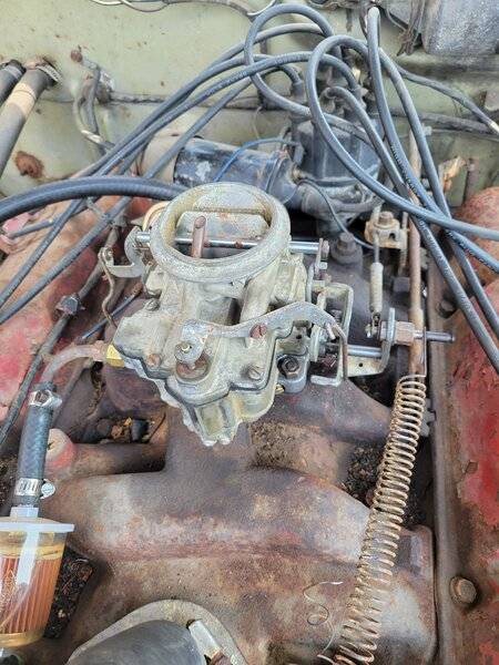

I have a 1966 satellite that has a 318 with oddly enough a stromberg 2 barrel carb. I've rebuilt the original carb 3 times and an old one a friend lent me that I've rebuilt once. The car idles and runs phenomenally but when you mash the gas the car stutters and then picks up. I found that the accelerator pump was sticking and you cold only move it by hand. Am I rebuilding the carb wrong? I put 2 drops of oil on the accelerator pump belt and put it in. And don't say I need a 4 barrel I ain't got the budget

Post a pic of what you have. The only stromberg I worked on was on a Triumph.

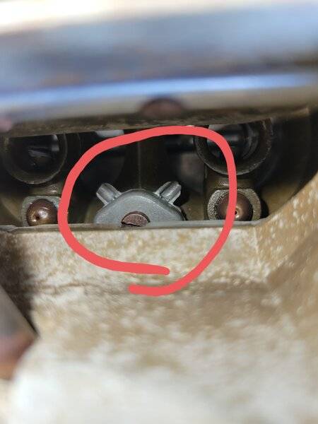

The Stromberg WWC3 carb were standard on 318 engines. The accelerator pumps were spring driven downward by a compression spring, located above the pump plunger and retracted by the external linkage to the throttle shaft. There are two (2) check balls located at the bottom of the accelerator pump well. The large ball is the inlet valve and the smaller ball is the outlet valve. Failure to install these check valve balls will result in the accelerator pump not working at all. It sounds as if someone did not install the drive spring or one or both of the check valve balls. If you still have the rebuild instructions or a copy of the FSM you eill see yhe locations of these items. The WWC3 carbs are very reliable and easy to maintain. Perhaps something was overlooked during the rebuild. Just my opinion of course.

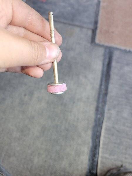

Addition to 'Bob', if pump has leather at the bottom; do a quick soak in oil & insert a small screwdriver on inside and "flare" the leather outward a little. If pump is "rubberized ", no oil needed.
I belive this one is off of a 66 a100
I also had to guess on this one... when I rebuilt the carb the rebuild kit didn't tell me witch hole I needed to put the smaller check valve in so i took a guess and put it down the hole with threads because the screw had a hole in the bottom of it. (This was all of course under the housing) I also know for sure I have the spring installed and the bigger check ball in the accelerator pump well.
This Is the accelerator pump from the first rebuild (don't worry it is only dirty cause it's been in my tool box) it is mildly flared but I don't know if it is correctly flared.
It looks normal to me. The spring inside should hold the flare open. Trouble ensues after sitting dry for a length of time and the leather dries and shrinks.
