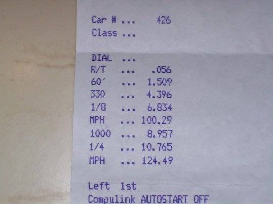

What are your et's and 60 ft times ? You may be able to get a comparison to my car as its run 10.70's. This is a time slip from my 3725 lb 63. Its a street/strip car and I use a Dynamic 9.5 converter that flashes about 4200 rpm. I shift around 6200 and trap about 6400 rpm . Ron
Thanks Ron. The car belongs to a friend of mine. Your time slip is very, very close. The car used to 60 almost the same with some dips into the mid-high 1.40's. It has a worked J converter that is due to be looked over. We did the Wallace calculator to see just how "due" it is. The next time we will do the calculator when the converter is fresh so we will have a good comparison. It's now doing mid to high 1.50's consistently (different tracks, different conditions). There have been some changes made prior to the season, a little weigh added, Dana 60 (still 4:30 gears), Caltrac's and double adjustable shocks. Tried several setups and had lots of help from trusted people that know suspensions. We can easily see slight changes but the 60's still hover in the mid 1.50's. It appears from all the helpful feedback that "acceptable" slippage is variable. At this point, a freshened converter will probably tell the tale.
1.50 on a 10.80 bracket car is pretty close. Now if the car should be a 10.65 car and the converter is holding back that's another story. You'll see Stock eliminator cars cut some pretty good 60ft. But look at the gear ratio and rpm they run. Not that bracket friendly
