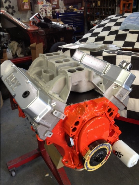

When you install a roller cam and cam button, you have to put a spacer between the water pump housing and the timing cover. This keeps the timing cover from flexing forward. So what holds this spacer in place? JB Weld on the water pump? Or brazed to the timing chain cover? I'm thinking about installing a roller cam in my 440. Just learning about all this.
I started welding plate on my covers to stiffen them up. It does not contact the water pump housing.
I like the idea of welding a metal plate to the timing chain cover. Thanks!
