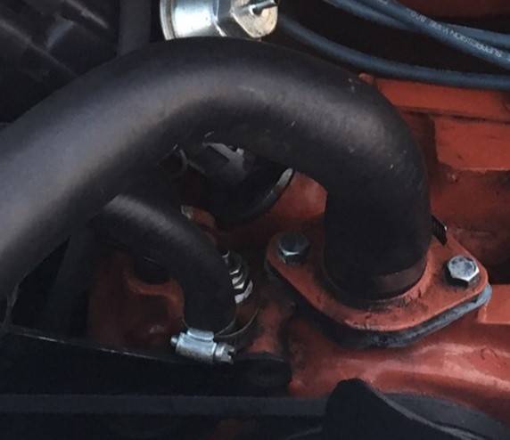

Let me correct a statement, after looking at pics of my motor, the current temp gauge sensor is coming out of the plug by the heater hoses (not the intake as I stated in my original post). Is there another plug I should look for?
The old 1/8 th temp sensor hole for the factory temperature gauge may still be there?
I do not know of any others factory threaded you could use.
I would assume most people running electric fans are also running a temp gauge. How/where are the individual sending units located? Or can both be run off one sending unit? I would not think that would be the case since the sending units may not be calibrated to work the same.
The factory gauge temp sender on my car is behind the alternator bracket below the heater hoses in your pic locating your aftermarket gauge.
Behind the mounting bracket for the alternator is another plug facing forward, there is a round hole in the bracket and the plug is right behind that hole.
IIRC that is a 1/4" NPT hole, you could add a sensor there for controlling the fan.
