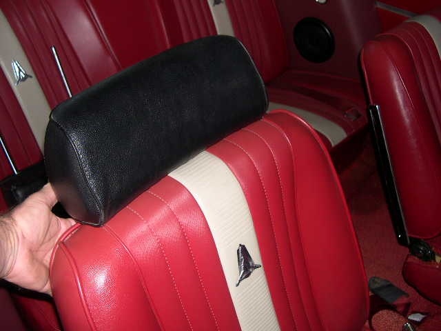

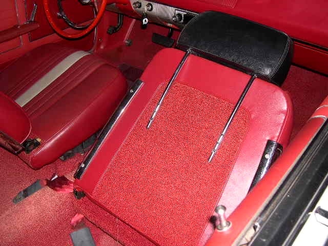

Interesting you mention (493 Mike) about fabricating as this is the route I'm on now. I bought some later B-Body headrests and as you'll see in the pic's looking at how to fab brackets to install them. I pulled away the seat back panel to find a horizontal bracket about mid-way that I'm looking to attach tubes to - to set the posts in. (I put the seat back together as I have a car show this weekend so didn't go too far for now.) the other issue is the top of the seat to accept the posts and may find it possible to drill through the frame of the posts. I hope anyway there's enough framework to accept 1/2" dia holes through it. Have to pull more of the seat cover away to expose the top frame railing. Otherwise look at more fab work here I reckon. And (Dennis H) you make a good point about liability had chatted with a buddy about this though the Legendary folks made no mention of this with our back and forth emails.

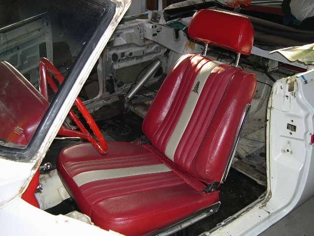

I found a local upholstery shop to install headrests on my '63 Fury buckets that was more reasonably priced than I thought. After some chatting about fabricating framing and buying late 60's mopar bucket seat head rest brackets (and the headrests) I now have headrests. Rest of the car is stripped down for repaint and engine build but thought I'd share what the seat looks like...

It was just good luck that I found the rests on ebay doing a search. I've seen them for sale on the forum as well. The brackets (the hardware for the top of the seats) are readily available from suppliers; can't recall offhand who I bought them from but can check my records. Could check with Joey here site admin as I've bought parts from him as a quick thought. The brackets internal for the seat were made by the upholstery guy easily formed and bolted in the center cross bar for retaining the posts inside the seat back. If you want me to check where I got the hardware can do.
