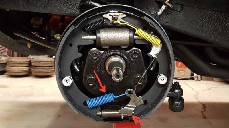

does this look about right:
24814360576_o.jpg?_nc_cat=110&_nc_sid=8024bb&_nc_ohc=19kSSFshoW8AX-j7PB0&_nc_ht=scontent.fagc1-1.jpg
Looks right to me. Make sure you have the right adjuster on the right side. When you look at the threaded half you'll see a "R" for right side, "L" for left side.
@jeff Mentzer
I can't see the adjuster spring behind the axle flange. I see the adjuster plate bottomed on the shoe. It might come up when the adjuster is lengthened. You don't want this spring to be too long. Check this.
This is a front brake but it's the same adjuster setup that you have.

yes, the spring is plenty far from hitting anything...the shoes are just your run of the mill raybestos pads

....I just want to note how immaculate that pic is....should help lots of folks wanting to get the drums back together straight. (like me of course....hehe)

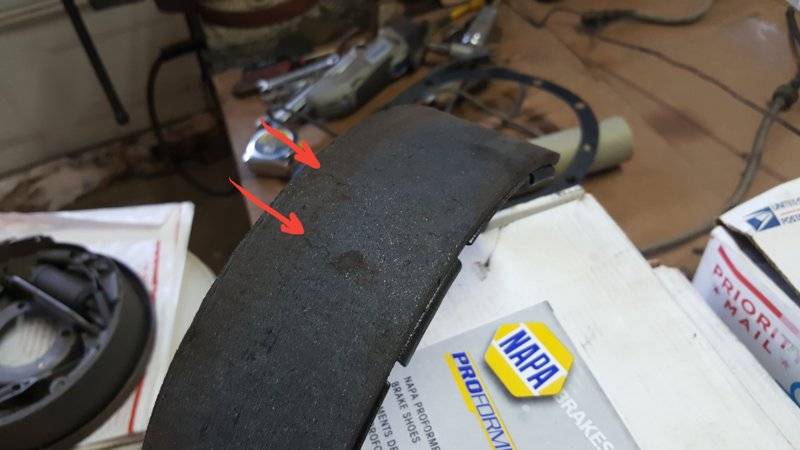

None are just run of the mill now days. I returned several sets trying to get good ones. That's the Brakes!
What was the problem with the ones you had to return? Been a few years since messing with drum brakes....can't believe 'she' has been gone for 3 years now so it'll be even longer before I'll have to work on brakes again lol
Even back in the day some consider we got good parts occasionally brakes did not contact the drums well. If that is the case the shoes can arched to fit at any good brake shop.
Miss matched sets mainly. You would find three rear shoes and one front in the same box. Had one with damage (cracks)

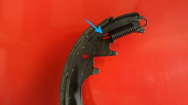

Then you get the different style hole for the later E-brake lever. It was always hard to get the early one with the pin to fit just right even though they thought they had designed a "fits all" hole. The bad thing is with the one hardware setup you need a round hole for the spring to hook in there right.
That's why I was curious where the OP found his. They look really good.
