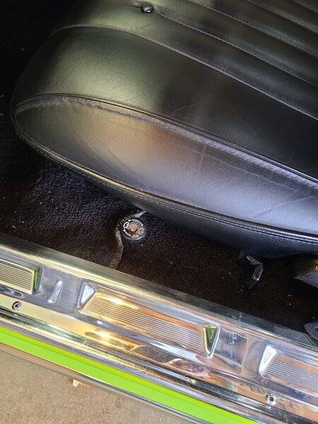

Have mine located under car at drivers seat for easy in car adjustment. No problems with any brake lights and not noticeable with carpet pulled over and door closed.
