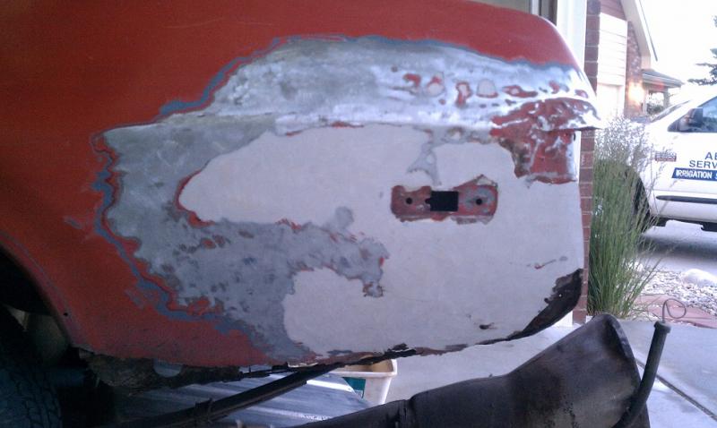

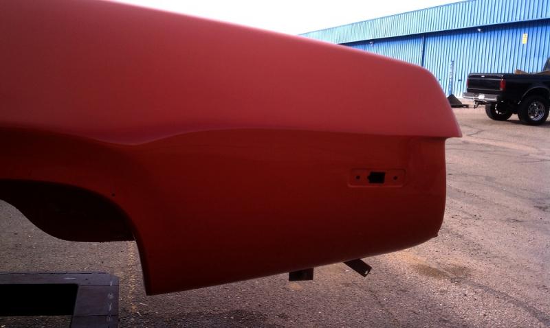

Here is the before and after of my drivers side quarter. I used the AMD quarter patch and trunk extension to take care of the rusted out area, and the area with bondo was pounded back into shape with maybe just a skim coat on it now, magent sticks the same every where, he did a real nice job on it!

It depends on a couple of factors. First, are you looking for a car to restore to original or one to drive around in and that looks nice? Most of the resto guys want metal back there, and the drivers just want the car to look good and don't care if it's metal back there or bondo.
The other issue is cost. Bondo or metal, fixing bad quarters is expensive. Depending on what your budget is, there's a lot you can get done with the money that would go to repair bad quarters, so I always look for cars that have good quarters because I know what a drain they are on the budget.
For me, my car is a driver and I put 200+ miles on it every week, so I wanted a body that looked nice but I didn't want to be sweating every chip, dent, or ding that it got on the road or sitting in parking lots. My car didn't have rust issues in the quarters, but damage from a tree fall caused some serious damage to the passenger-side QP. My body guy banged it out, then used a thin layer of Bondo to finish it. It's not 100% metal, but it looks great and it didn't break my budget, so it was all good. :)
