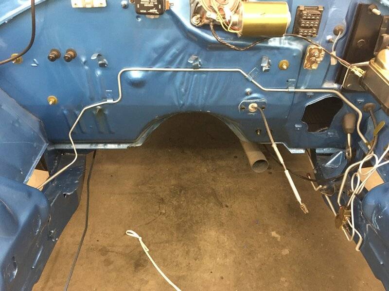

Just did this on my 69 bee and used the inline tube kit they have for the manual disc/drum.
The bends were spot on turned out really nice just needed a small amount of tweaking
DBB6808 on the kit and I agree with TMM the steel kits are the way to go.

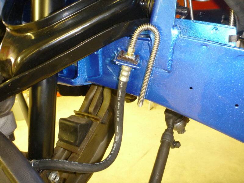

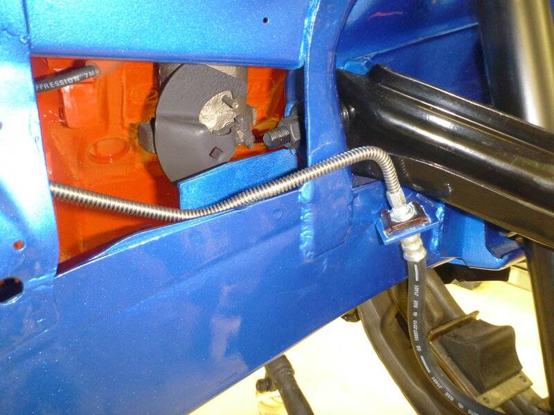

I've had zero issues with my stainless lines from Right Stuff.. Sounds like your just need their drum kit (power or manual???) and on the passenger front you need to specify if the line goes under or over the frame rail.
https://www.getdiscbrakes.com/
How would I find out how they route? I got the car stripped. Is there a certain way to tell?

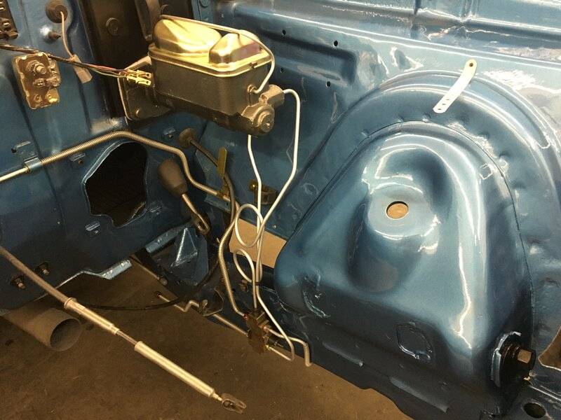

I used steel lines from right stuff detailing on my 68 coronet. Every one of them, bends were perfect. Zero issues, would definitely use again. Both my cars are using their disc/drum master cylinder too. I think it's listed under E-body cars though.

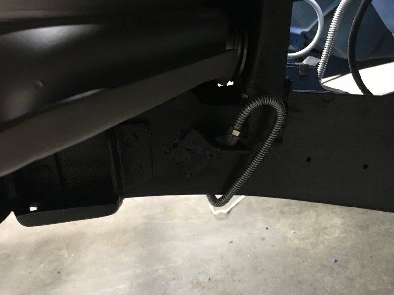

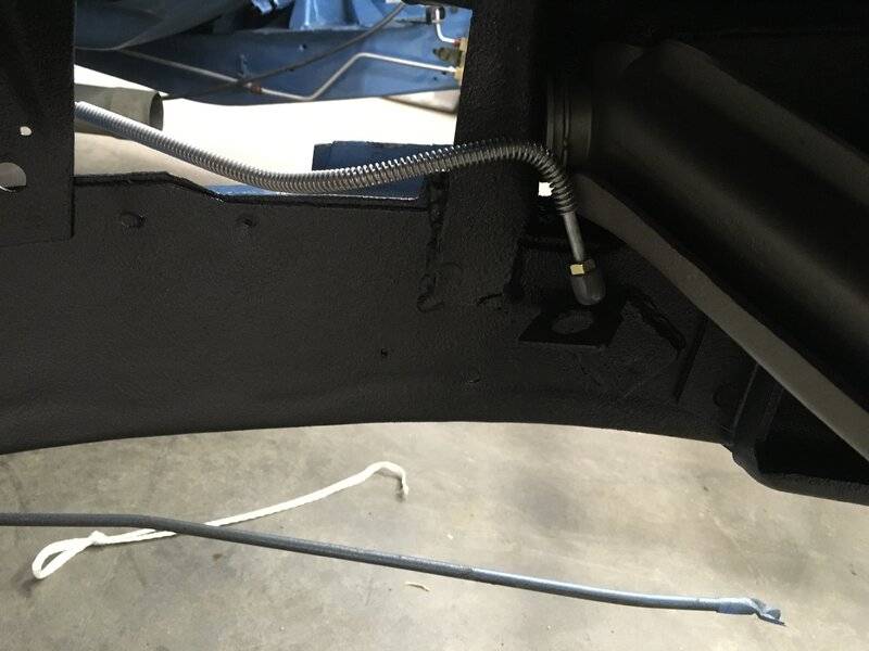

The fitting/bracket is the same either way for the hard line to flex transition. Do you have the rubber flap that fills the UCArm adjuster hole. If so, if it's all deformed around the line slot would tell you it was originally over the rail. If not under.
Mine.. Drivers side under, passenger over..
Mine.. Drivers side under, passenger over..View attachment 1024568 View attachment 1024569
Same on my 68
