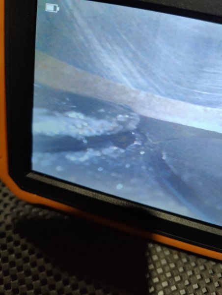

I did a leak down test just to be sure it wasn't messed. I also took a pic with my inspection camera. This is the one piston that was oil soaked the most. The walls looked good. But I'm not sure if that valve is shredded or that's carbon buildup. Not even sure how the valve could get messed like that when all the rest is good.
What did the leak down test say? Should be no carbon with a 1/2 hour of run time. Were these heads new or rebuilt.
The heads were rebuilt. I got 93 on the leak down. I can't wrap my head around what that is. They were new valves. If it was metal I'm guessing pieces would of fell on top of the piston by now. That's why I assumed it was carbon or oil. I was running rich.
New valves are pretty useless in worn valve guides. What is the condition of the guides?
The heads were done at a machine shop along with the block
Ya I can't even recall if he did the valve guides. I will try running it and see what happens. I checked all cyclnders for leak down and did a compression test. 150 to 165 range in compression and 5 to 8 in leak down. Everything seems seems good. If I need to take it out I'll check the head first and see if the guides were done.
