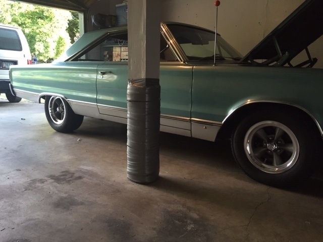

Personally, I just put US Mags U102 Wheels 15x7 with 3.75 Backspacing for the fronts and 15x8 on 4.5 backspacing for the Rears on my '67 Satellite. I think they look great and they are $75 cheaper than Torq Thrust D's..
https://www.summitracing.com/parts/usm-u10215806545/overview/

Your car look good with those nice choice!
