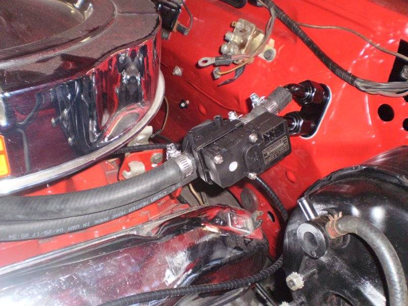

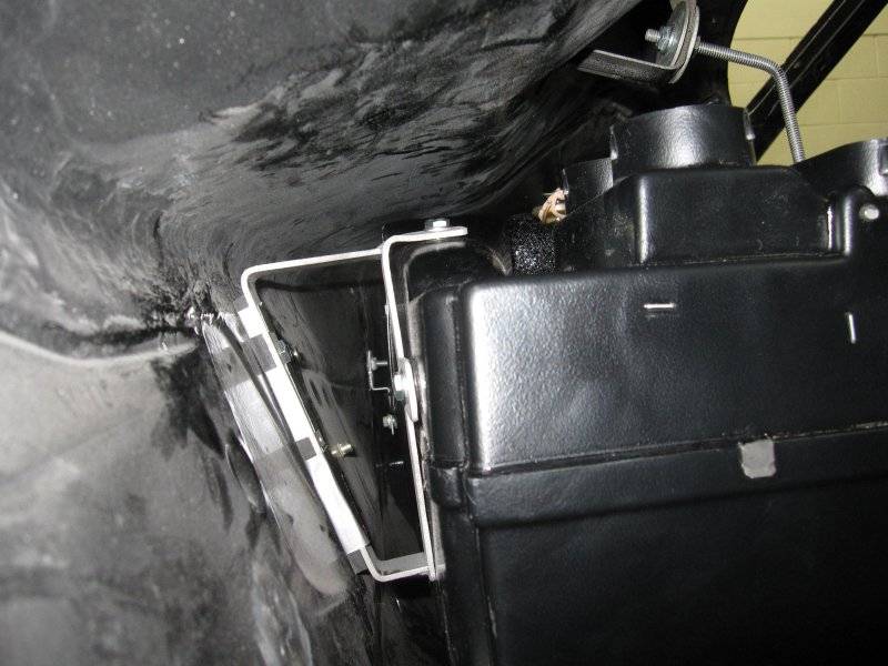

My 65 Belvedere installation: Vintage Air, I went with the smaller unit as I have greatly enlarged the tunnel. The water valve is attached to the USCT inner fender brace I installed.
Mike

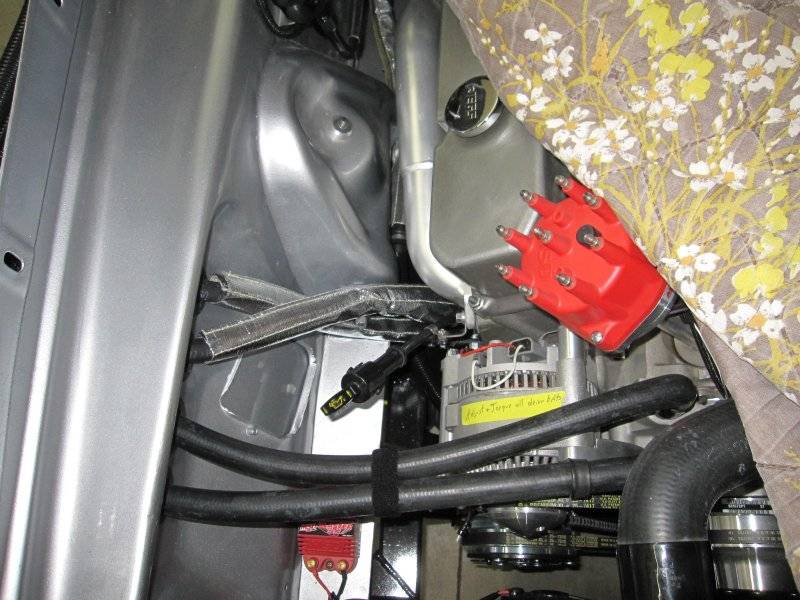

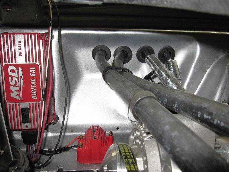

More: I fabbed a cover plate for the air intake and used bulk head heater hose fittings. The A/C hoses run through the plenum grommeted at both ends. I ran all the front wiring through the plate also.

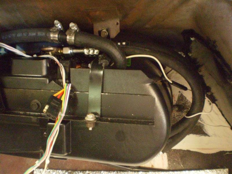

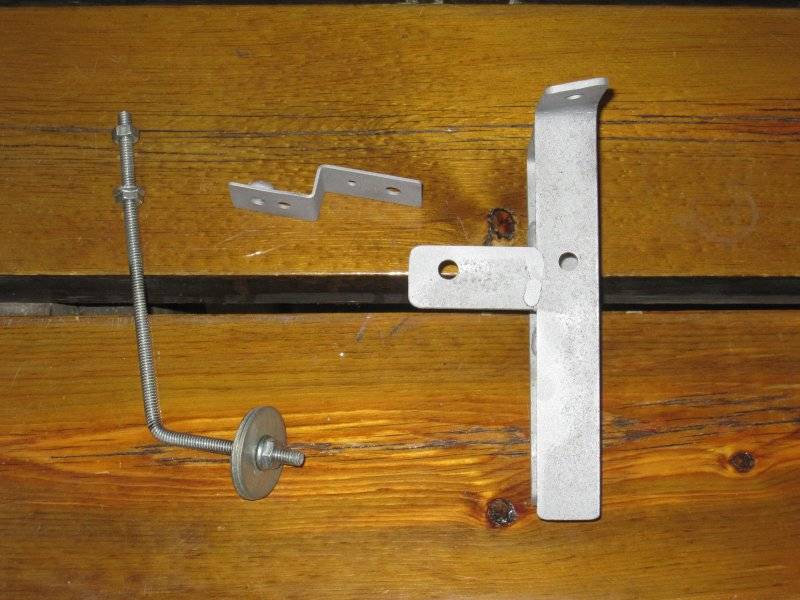

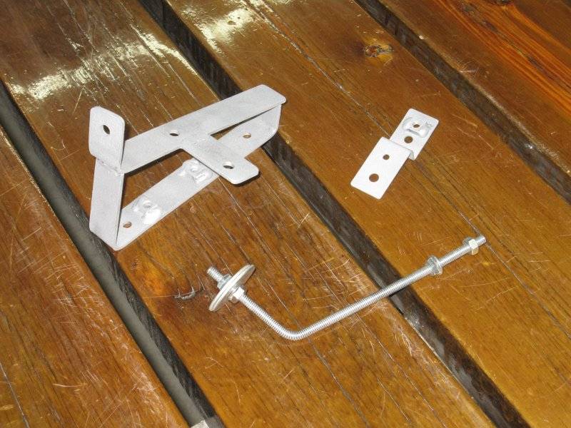

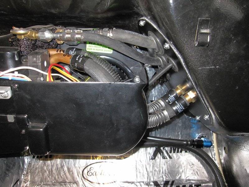

Here's mine. Vintage Air, completely under dash on '64 Polara. If you are interested, I can look through invoices and give you a list of pieces I used. I did a pretty comprehensive post on '64 Forum of what I did.

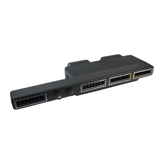

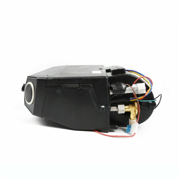

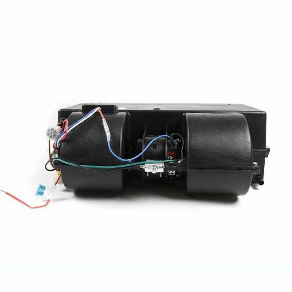

Thanks guys. Super nice setups. I am really just wanting a cool only underdash evaporator unit. Much like the aftermarket units that were so popular in the day. My heat works well. no leaks, no drips. The units that I have been finding seem to be sized for early Mustangs.
I think that something thin with the controls in that part going over to the components over to the right side closer to the glovebox area. You know how little space there actually is under the dash in Early B's.
Thanks again.
Hoping for more responses.
These units are just way too big. It appears that they all have the same total dimensions, even with a thinner face. That's why I'm thinking thinline controls and works way to the right.
