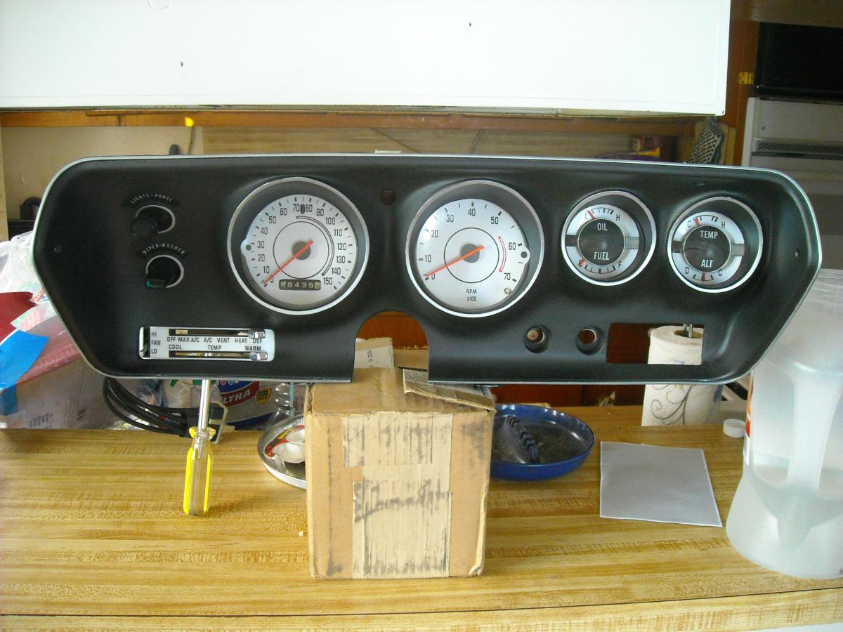

I cleaned up my stock gauges.....

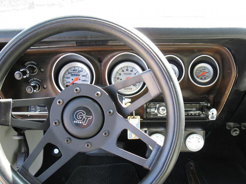

Ya, the 71 Satellite I just bought has a custom cluster.
The gages are Autometer classic street rod. The speedo & tach are 3 1/8" dia and the rest are 2 1/16" dia.
I'm taking it all out & replacing with a stock cluster.
I may have asked these questions before, because I love the look of that, but is the cluster a flat black?
Also, where did you find the gauge faces?

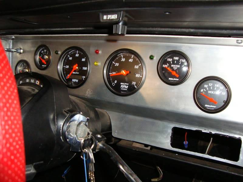

There was a fellow on MOPARTS, user name Jerry, that made a custom insert for the non-Rallye '71-4 dashes. It used either 5 or 6 AutoMeter Gauges, 2-3 3/8" Gauges and 4-2 1/8 Gauges. I checked thier user file but it does not list a E-Mail address for him.

I apologize for missing this earlier. I'm currently running for President of the Short Attention Span Society. I sanded the stock housing down and painted it flat black. The silver trim is done with a paint marker from the hobby store.
I refaced the stock gauges with a kit from Whitegauges.net
http://www.whitegauges.net/products/1971%2d1974-Dodge-Charger-White-Face-Gauges.html
Oh, and I probably have about 40 bucks into it.

I did my cluster in a pretty light gloss black, and thought of doing the insides of the bezels in silver.
I love the gauge faces!
