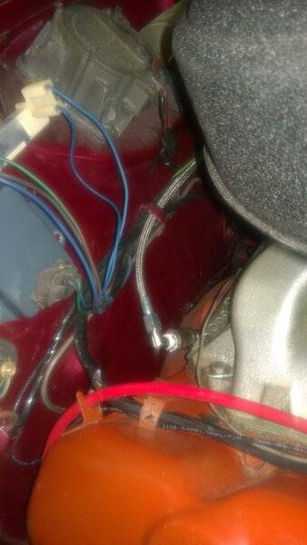

I heartily agree with Ed! Plasic is risky, and not legal at the drags, i dont care for copper, because it work hardens and cracks, if it moves when the engine moves.
I use a -3 braided line that i got from an aircraft surplus store, didnt cost much. Peace of mind, and drag strip legality was worth it, to me.
