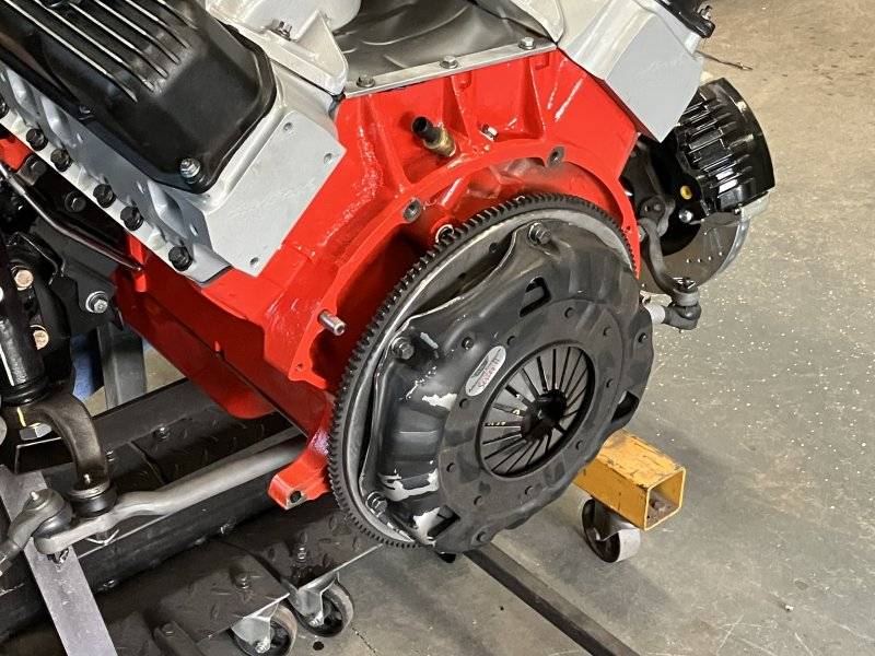

The oil in the pan is not under pressure which to me, would mean that the temperature might be lower.
The LA and Magnum V8s only have the one threaded pressure port at the rear near the distributor, right? Big blocks have the two:
On a small block, maybe you could use a "T" at the standard pressure port at the back?
