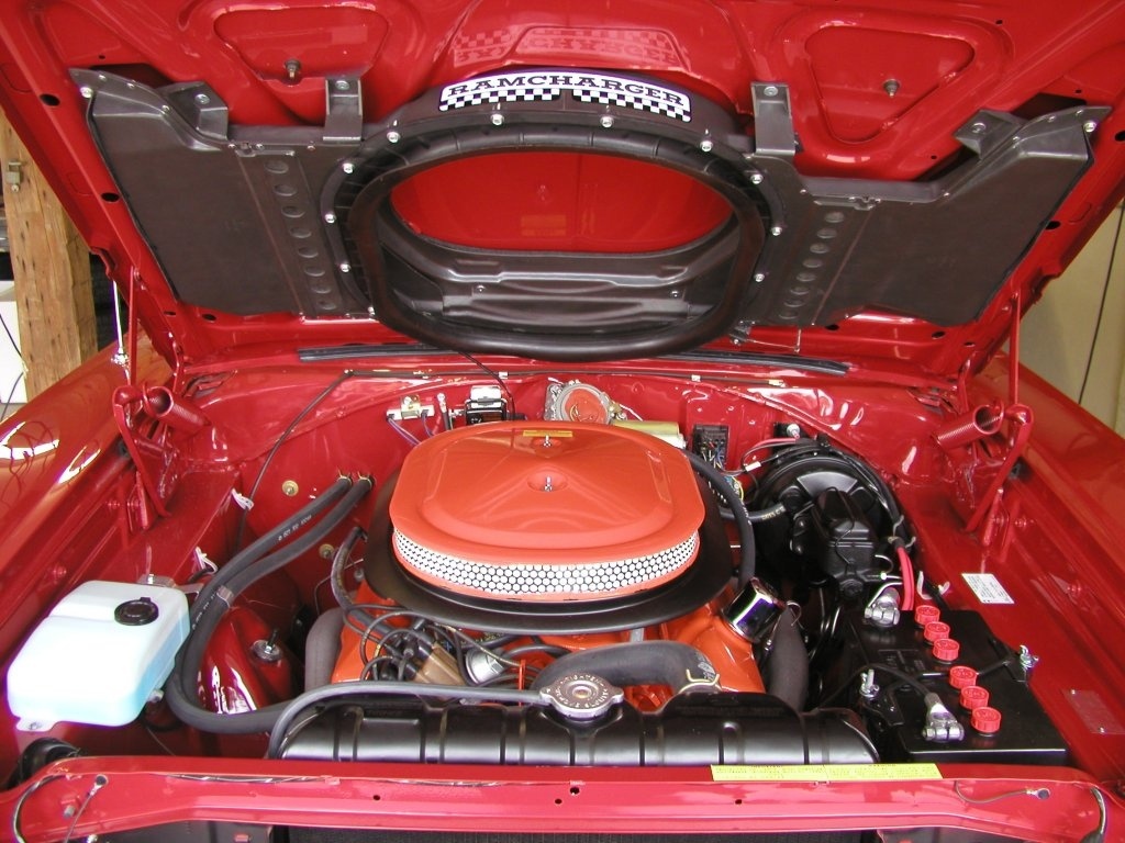

You will have to use the Edelbrock aluminum RPM manifold #2186 (not the Performer RPM) and then use the shorter version air cleaner base (440 version is 3/4" shorter than the 383 version) to achieve what you are looking for. I've done it and it works. I took a lot of measurements on many different manifolds to come up with the data to figure out the height differences to make it fit under the Ramcharger hood. This manifold provides the highest air flow I could find yet is still short enough to allow use of the Ramcharger.
http://www.edelbrock.com/automotive/mc/manifolds/chrysler/performer-bb.shtml
This is of course assuming that you have a 383 or 400 LOW BLOCK engine that is in the car. If you've got an RB engine, then disregard this post, you are on your own.
Here's a pic of the assembly, of course you can't tell from the photo that this is the RPM and the 440 air cleaner base. But that was the object in the first place, to make it look like a factory stock setup.
