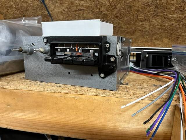

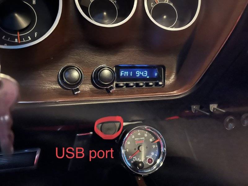

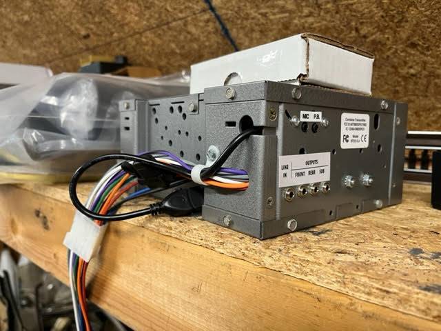

I sent an original for both my cars to Gary Tayman and he restored the faces and installed a modern AM/FM with aux and bluetooth. They have amp outputs. I run the front dual 3.5 speakers off the head unit and rear Rockford Fosgate 6x9's off a Fosgate amp. Great sound original looks.

I had my original AM radio converted, and I run 5 speakers plus a subwoofer. Everything is hidden and looks stock, and the system sounds awesome.
My only complaint is the AM radio makes it hard to tune a FM station because you don't know where you are on the dial. If I had it to do over again I would have upgraded an AM/FM radio.

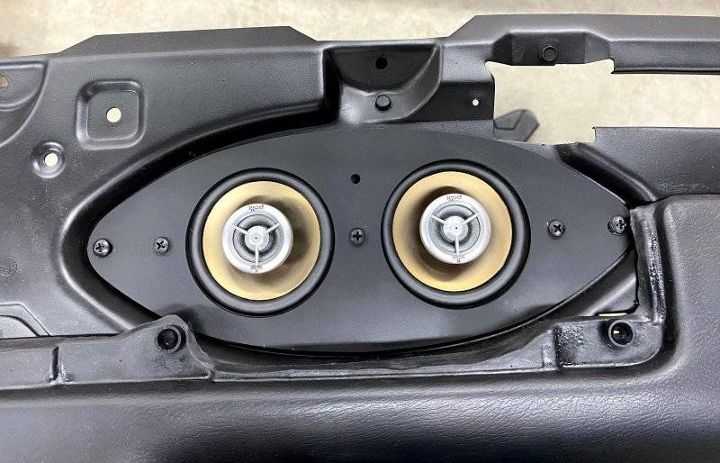

Did you make the plate for the front speakers or was that something you purchased? It looks great and I can certainly fabricate something like that as well but I do see there are a number of dual front speakers on the market. About how much was the conversion of the radio?
The AM I did was $525 but I did not do USB or Bluetooth on that one. AM/FM was $625 with all the options he had. The front speaker mount I got from Turnswitch. They don't have them on the website but they sell a dual speaker setup so I emailed them and they sold me a couple for $11 each. Would be pretty easy to make too.

This is the speaker I put in front. Bass sounds are not directional, so it has one speaker for lower sounds, but also 2 tweeters. This is a direct bolt in speaker and I am happy with it. I recommend it if you are trying to keep the car stock looking.
