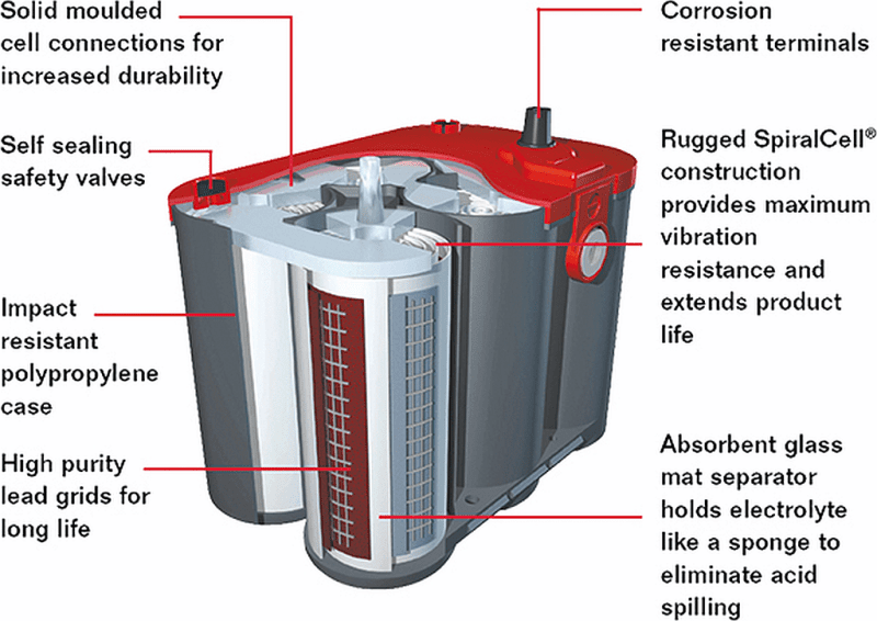

The agm optima reds I've had weigh at least what a lead acid battery does, and in my case in my diesel pickup, didn't last any longer.
I compared warrantee of Sam's agm (die hard?) to their lead acid, and the warrantee and power were the same. Would have been over $500 for two optimas, got two lead acid for less than $250. If they last more than half as long as the agm's, I'm ahead.
On the other hand.... my Opel has ABYSMAL battery access, and currently a optima red doing fine. When the time comes, it will get another.
Most likely because AGM batteries are lead acid.
I was going to add that to one of my posts, but I specified "lead plate acid" for "regular" batteries.
AGM benefits from the design, IMO, especially if leaks on your classic car would be something you want to avoid.
