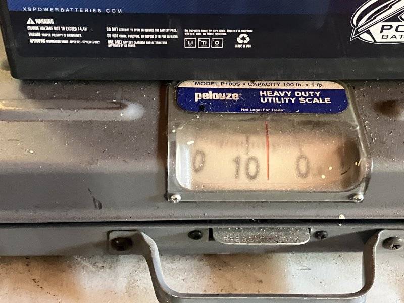

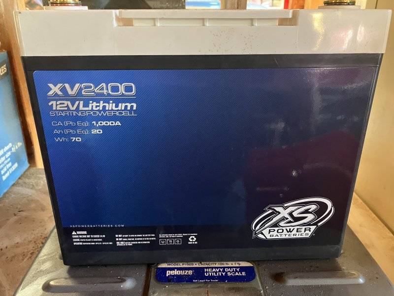

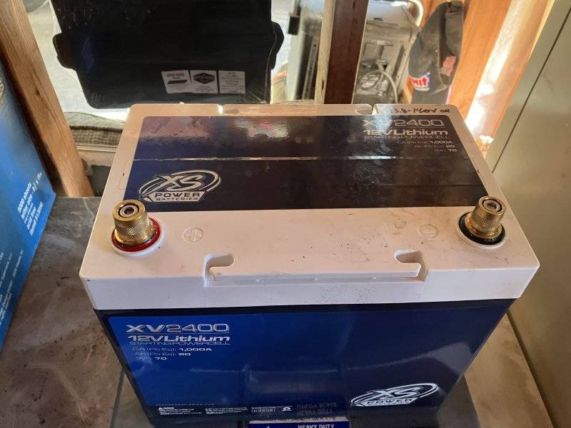

I posted a link to another thread here. FBBO member J C C started a thread about one he found for $200. It weighs 6 1/2 lbs instead of 40.
