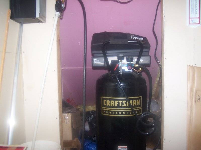

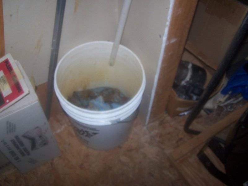

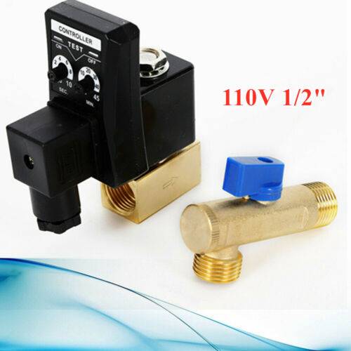

This is the one I installed on my compressor. About 30 bucks on Ebay. Electronic timed Moisture drain. I had a habit of forgetting to drain the tank so this took care of that problem. They are adjustable so you can set it where you want. I have mine set to bleed for 10 seconds every ten minutes. Seems to work good. I piped it into a 5 gallon bucket but there is never any water in it.
Is that your drain line, way up higher than the compressor??? Maybe that's why your bucket stays dry..... What are we looking at here?
Yes it is. That black hose is routed from the bottom of the tank where the water accumulates. The pressure in the tank blows it out whenever the timer valve opens. The bucket stays dry because it kicks out any moisture at the bottom of the tank every 10 minutes. I used to get some moisture in my separator before but not any longer. It works, believe me.
