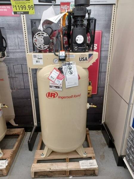

I posted in general discussion that Tractor Supply has an Ingersol Rand 80 gal 5 hp 2 stage compressor for sale for only $1200. I was at the local store yesterday and they had 2 on display. They looked pretty good. Cast iron compressor, big metal belt guard. Here's what it looks like. Sale runs through Sat 11/26.
