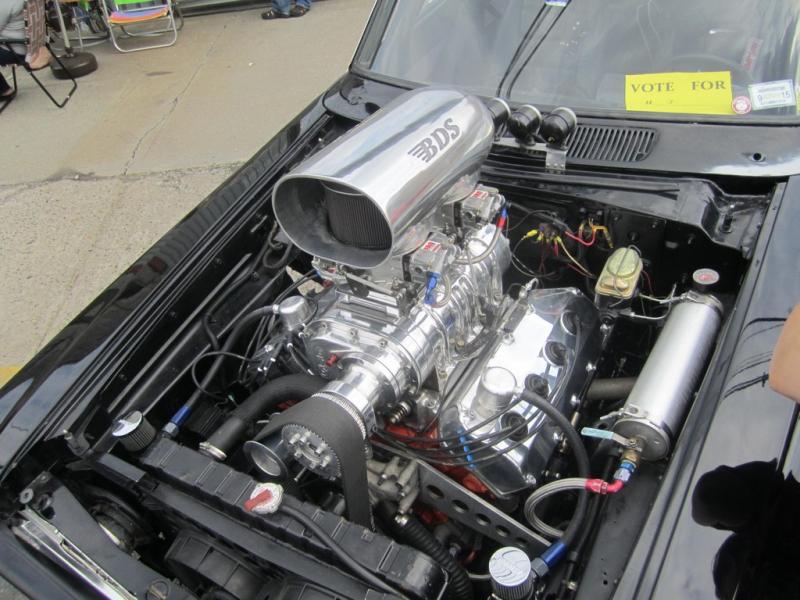

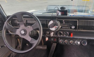

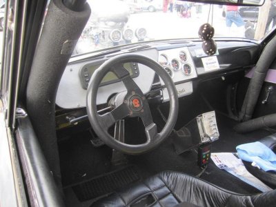

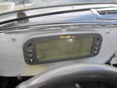

Really depends on how much data you want.I went racepak because they are supposed to be the best.I really need more than just o/2s.
Hemi-Itis...your car is just sick ! LOL. wow...what a car.

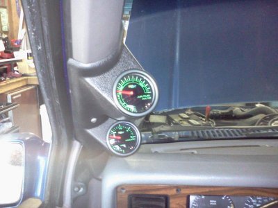

I got Glowshift brand on mine
