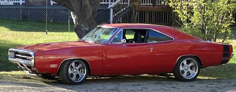

W I D E tires are cool.
I’ve always liked your set upW I D E tires are cool. View attachment 1455775
LOL!!!
